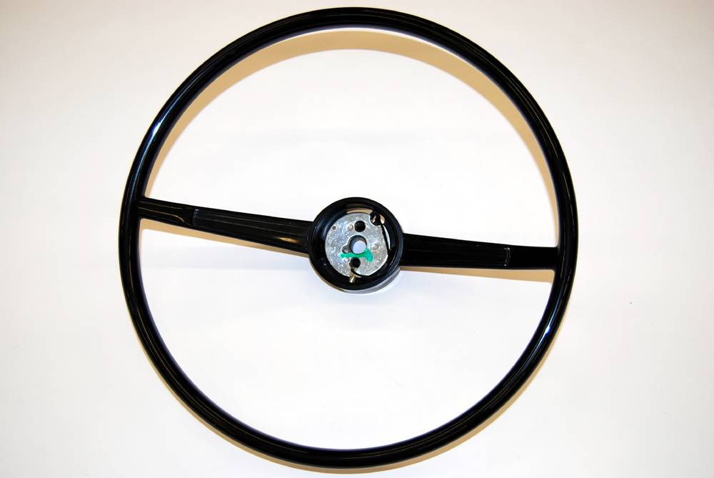

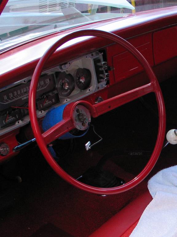

Have you checked the repo of this wheel? I bought one because I couldn't find a decent original (and mine was missing). Overall it's a pretty good wheel for the price.
http://moparplus.com/product_info.php?products_id=1059

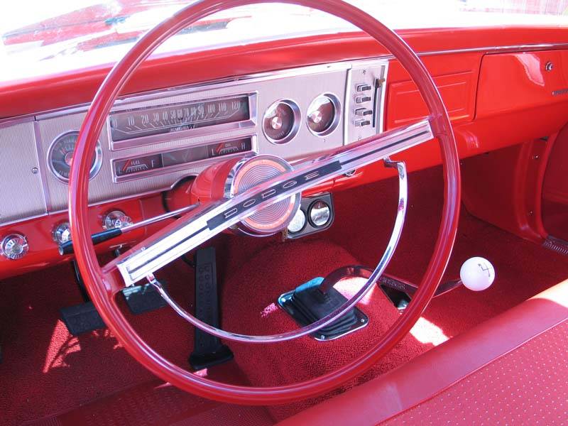

Here's mine installed-
I've heard that the repros aren't quite correct, but not too bad. I know of an original '64 wheel all beautifully restored that's for sale. It's not cheap, though - $500. I was thinking about it until I found a really nice used one for $20. that I can restore myself.

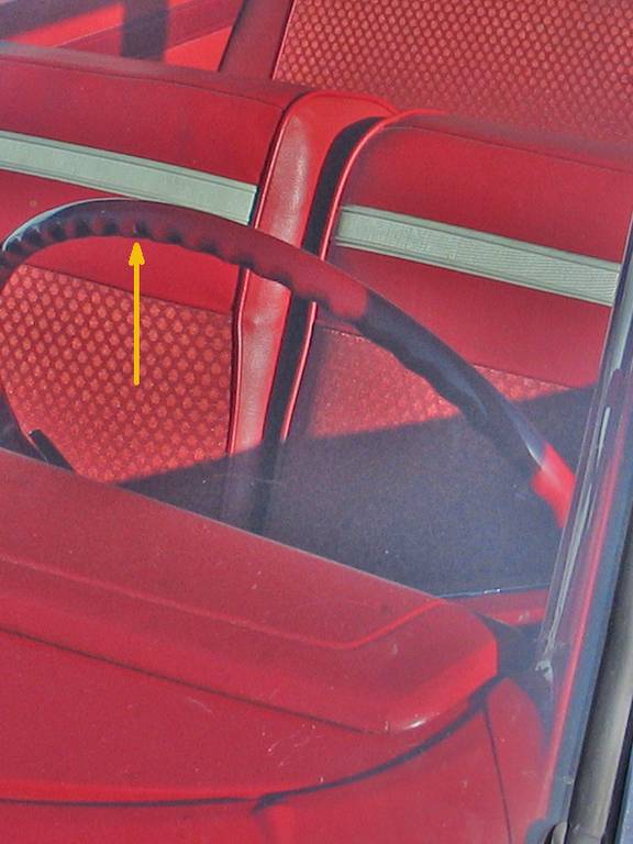

You're right I think that they are not quite correct. From what I understand the main difference is four casting holes in the backside of the wheel which the original did not have. They are about 1/8" holes that are maybe 1/4" deep. You really cant tell day to day. There may be other differences but that's what I know.
This isn't a very good pic, but it does give you an idea of the holes. I can snap a better one if anyone is interested.

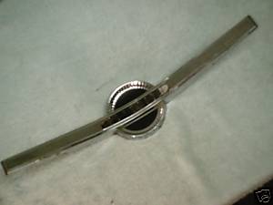

This is the same as the one I'm planning to use. I thought all of the '64 wheels have that slot and this bar works with it. Maybe not?
Yeah that bar will work as it screws on from the backside but you'll have that slot in the steering wheel exposed without the chrome ring.

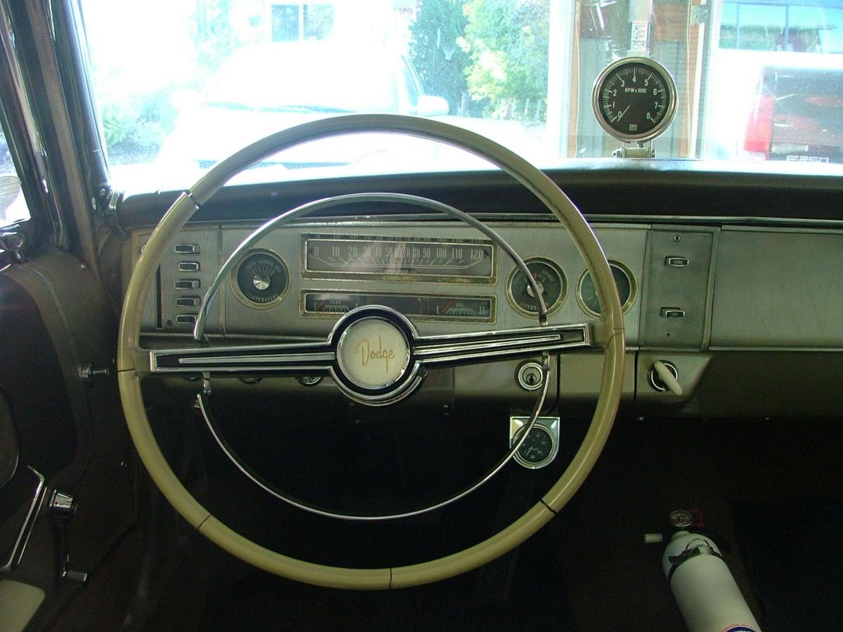

My wheel has more crack in it than Harlem!
Fortunately, the wheel's not deformed and can be repaired easily. Must be a fairly common thing because every one I ever seen has many many cracks.

Your wheel actually doesn't look that bad compared to most that I've seen. We could start a thread for who's got that crappiest wheel contest. I feel like I could have a real chance here.
The wheel in my 64 is very similar. Must be the nature of the beast. When time comes to get her on the road I'll just get a repro. I was actually going to send mine out to be redone but the back side of it is all spider cracked.

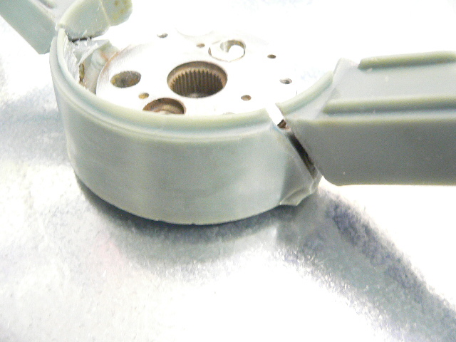

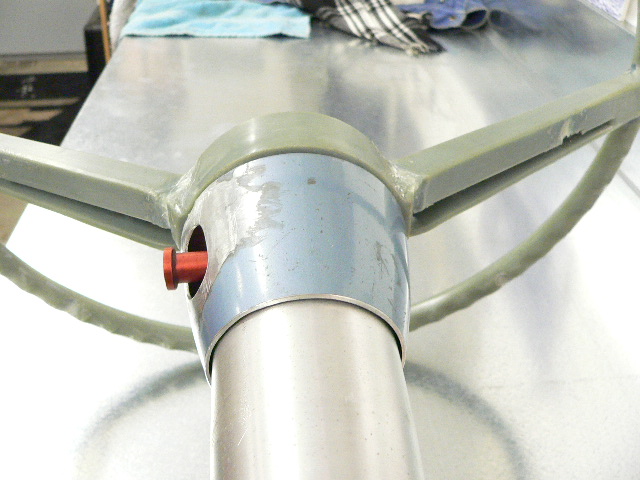

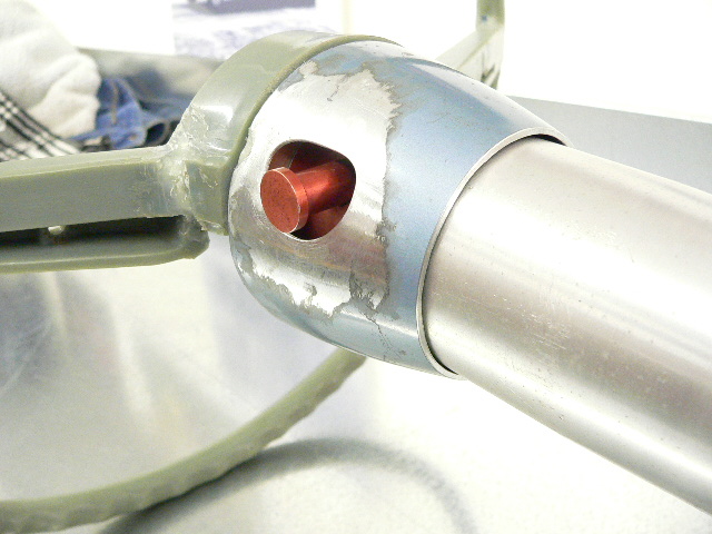

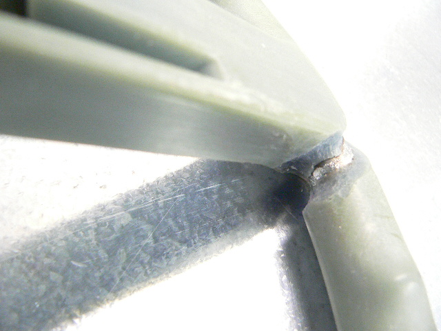

Not that hard to repair. Grind out the cracks. A little epoxy , then some bondo and Whala. Just paint with your choice of urethane. My body guy says they stay crack free. Sorry no pics in primer but trust me it was quick,easy and looks like it has never been touched. These pics are epoxy only before filler.
