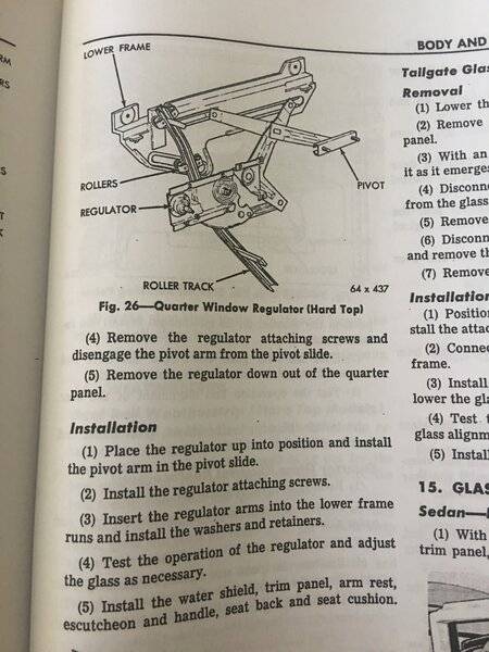

Hello, anyone know where i can get picture or print of one assembled as if it were
on car, car came disassembled. Thanks
Best I can do right now is the FSM
Thanks for the information, i will definitely be buying
one of the books, thanks again for all your help,
