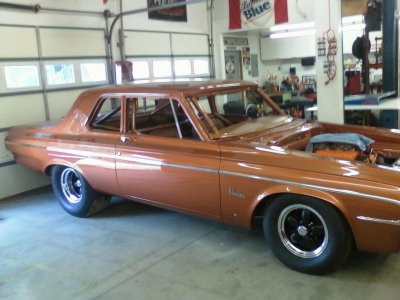

It was not that big a deal. Look at the fit.
Doug
