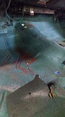

Short question is are the holes for automatic cables & do I cut the car up past putting it back to original in the future.
Floor pan has been replaced so have no clue if it had a hump or not

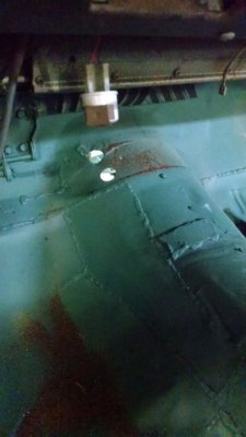

Welcome from another MI Mopar person. I am far from an expert on this but from some pictures that I've seen, the manual hump would have been in the patch area below those 2 holes on your car. I have a 65 Coronet 500 with the 727 automatic console shifted. I recently put my interior back in (minus the carpet) but is looks like my cables are going into holes in about the same area. I believe you can get a repop hump at AMD or classic industries. Good luck with the project.
Just concerned that the holes WOULD NOT be their if was really a 4spd car. The pedals don't look to be tampered with but it sat in a guys garage for 7years after being blasted cause he was so disappointed in all the wrapped panels that he gave up.

I don't know for sure, if the two holes would be there, for a standard trans. Though it could be the same for either auto, or standard. One hole for shift cable, one for park cable? 64 parts book could tell if their the same, or not.
Aw, heck, I'll have to look when I go to the shop today. Think I remember cable shifts go through one elongated rubber boot. Doesn't help, since I've only had auto cars.

All the 64-65 B-bodies had the holes stamped in the pan! They were not drilled though! That is the general area for the holes shown in the pics.

Yes, the holes are for the auto shift cables. Never had one, but from info I've seen on clutchflights, pretty sure shift cables are used. And, no hump, though if it is originally a 4-speed car, no say, since pedals are there.
Is there a console with the car? The floorpans replaced...but don't see the mounting brackets for a console.

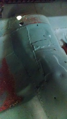

Got the 4 spd hump from Brewer's today. ( Called 3 pm yesterday and it was on my porch today Great service)
Anyway from the way it fits the floor is perfect but it covers up a bracket or part of one that's welded to the tunnel has me wondering if it was really a 4 spd car.

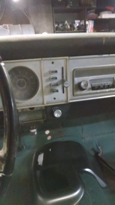

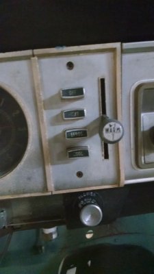

Have not seen enough of these cars to know where the push buttons would have been in the dash. But the only space in this car is to the left of the steering column. On the right between instruments and radio is heater controls.

I have a 64 Fury. 727 Pushbutton trans. Cables go threw oval hole in firewall below master cylinder area, also had a 65 Plymouth. cable drive. cables went as in your pic
That is a piece of the console mounting bracket! I don't think it was an original 4 spd. car.

Seems that if cables ran thru those 2 holes that would be a pretty sharp bend.

It should have 4 holes on each side of the drive shaft tunnel for the buckets! Also 2 more console brackets. The SFs always came with buckets, You could order a Fury with buckets and no console!
