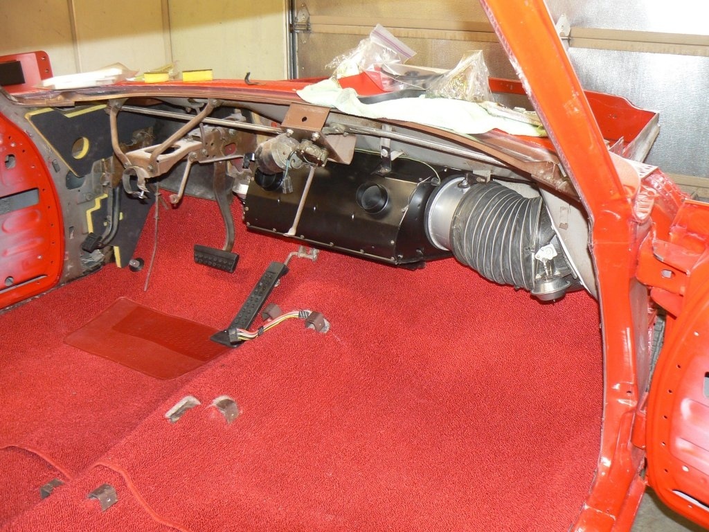

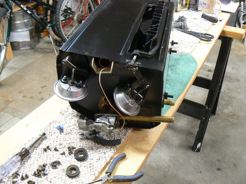

hello. Got a a/c heater box. The Warm Air lever on these, does it attach to the lower part of box that opens the lower pods, also on the 64 was there a VENT lever mounted under dash for pass side, if so where does it connect to. This was was not mounted when I got project. Thank You
Warm air lever goes to the hot water valve. When you push the cool button it opens the fresh air on the right. If you are missing pieces, shoot me a PM. If you have AC it is different than this. I have not messed with the AC ones. I like my 4/60 AC.

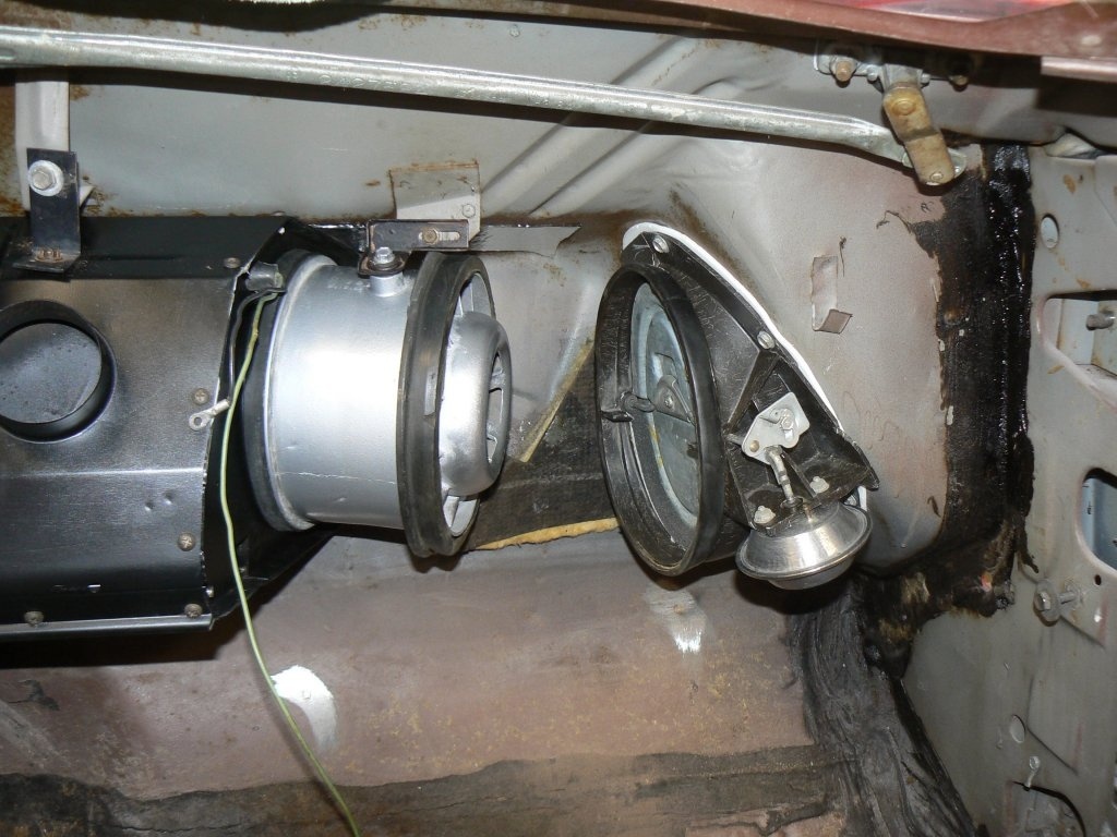

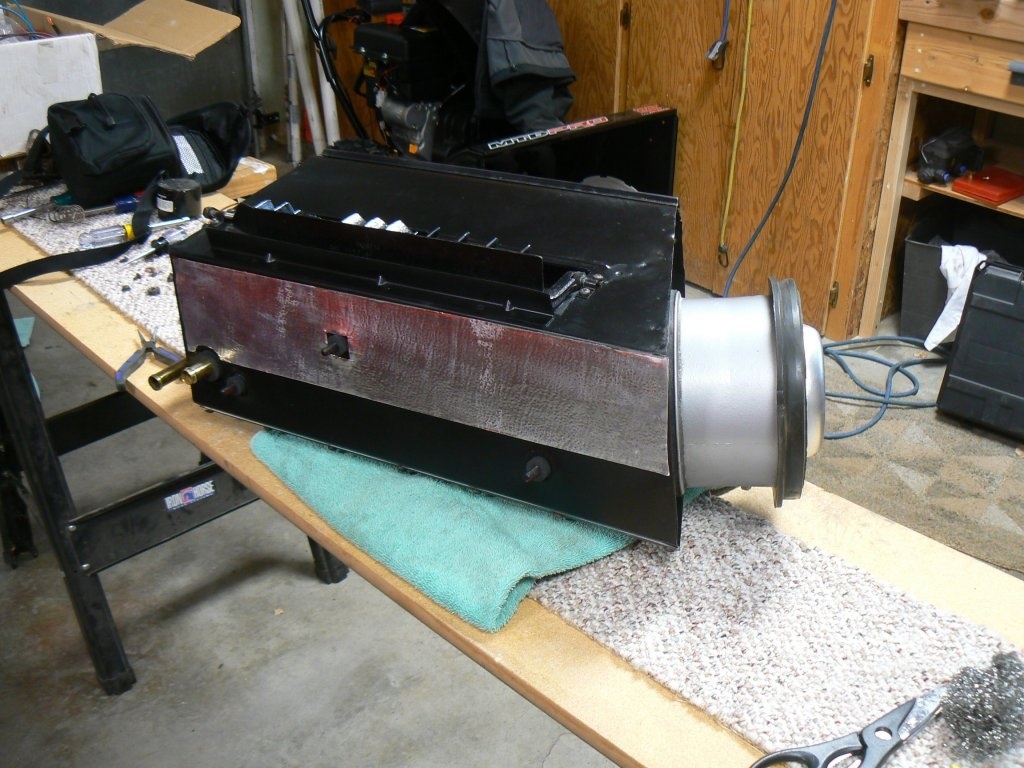

Thanks Kenton. This is the box in mine. Different. 4- vents ?
Looks like the fresh air is the same, What does your switch panel look like?
I am just guessing, but the two vents coming out the front must go to the AC left and right under the dash. You will also have defroster vents on the dash top that pivot up for AC,and lay flat for defrost.

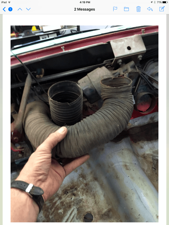

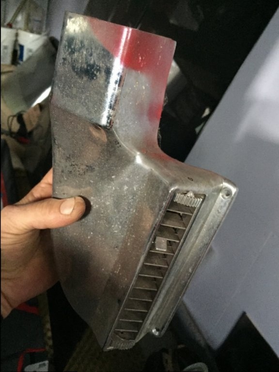

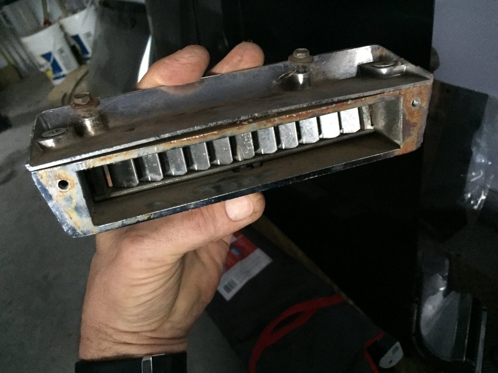

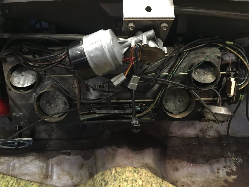

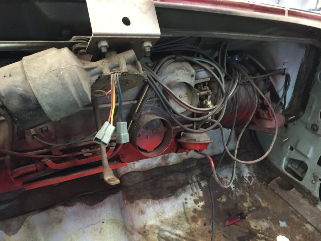

Yes I have. 2- vents on top of dash, when you say 2- vents out front, there's 4. 2 bigger than the others. The one pic here is when I took dash out the where 2- hoses hooked up. Others where missing I guess. Nothing in manuals. ?
Those two must go to the defroster vents. They both point up. You must be missing the hoses for the under dash mount AC vents. I see the heater control buttons have 4 buttons and one lever. I'm not sure what brings the compressor on, not seeing a with for that. Maybe on AC cars it comes on with the cool switch.
Think your right. On the dash the switch does say cool/ heat. Yes must be missing some tubing. Thanks Keaton. These cars are always a mystery, and of course when you get one that somebody else started and a lot of parts are in boxes.
