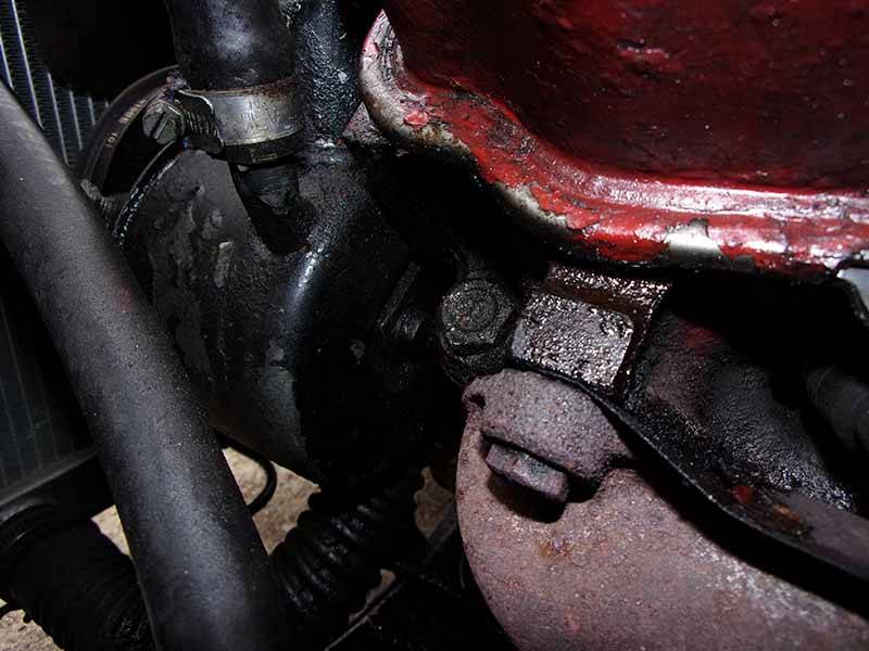

Hello all,
I'm a french owner of a 64 Plymouth fury 2 doors hardtop 318ci. I recently bought this one after 6 years with the same car but 4 doors hardtop and more rust on body.
I need your help to identify my power steering pump and find the correct seal kit to fix a huge oil leak. see picture below. Thank you, Fabrice

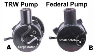

@Lefty: I read the post and if I understand this picture, I have a TRW pump?
I read Chrysler or Saginaw pump mounted for my car?
As this car is the only daily car we have, I would like to buy the right kit.
Thank you both, Fabrice

Yes, it sure does look like a TRW pump.
Looks like a TRW pump, same one as in my '64 SF. Can get rebuild seal kits from Rock Auto for pretty cheap. Can also find pulley pullers on ebay for ~$25. You'll need that to get the pulley off the front. Don't try anything other than the proper puller, you'll end up messing something up and regretting it.

"Chrysler" pump can mean Federal pump '67 and later or TRW pump '66 and earlier. Look in the description, one of them says "slotted shaft", that's a TRW in my experience, never seen a Federal with a slotted shaft.
Trying to stay in the loop on this thread, because i may need this info as well....... I looked at the pump on my time capsule of a 64 Belvy, and the pump looks just like your pump shown in the pic in post #1. Yours (and mine) are more similar to pump "A" on the left in post #4, yet they do not have a return line like either of those shown. So, is that still the TRW pump??
It seems most of the TRW pumps have a poorly soldered, 5/8” return going in sort of vertically. The one in the photo is less common.
