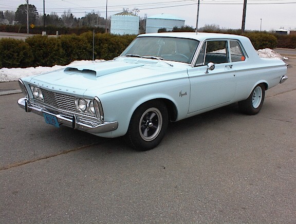

Well I believe the factory did cut them. I run the Max Wedge scoop on my 63 but I run a single Holley carb and have a glass hood. Ron

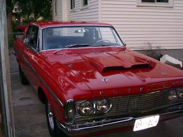

ran the same thing on my 63 ply savoy, one air cleaner rubbed, got a different hood and cut the braces and put the scoop on. 63  Max  Wedge 001.jpg

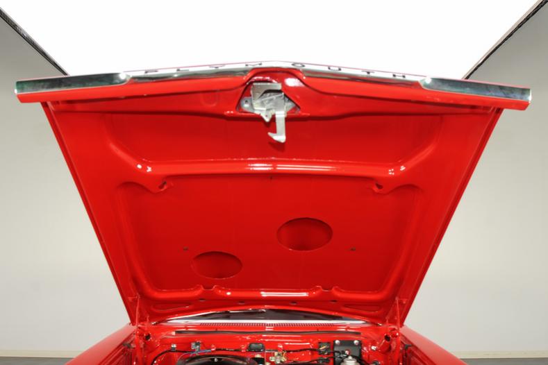

The braces on my 64 with the MW was cut from the factory!

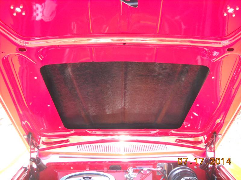

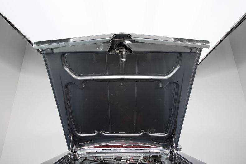

Thanks alot guys I really appreciate it. Would anyone have a good picture of the brace and where it is cut at????
under hood

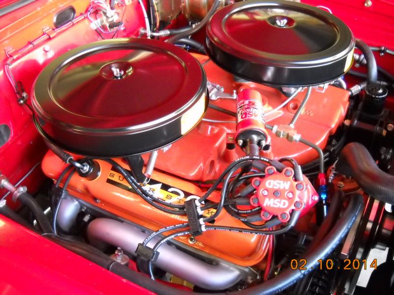

Here are a couple pictures of 2 documented cars.
Without a scoop and with a scoop.
Hope this will Help
Jeff

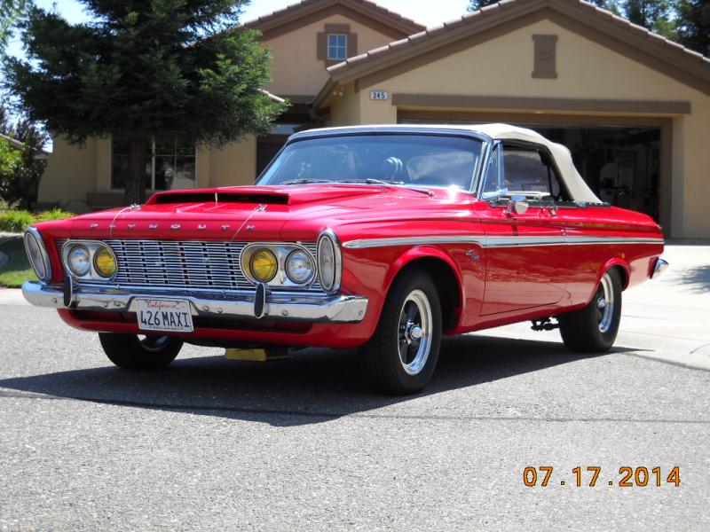

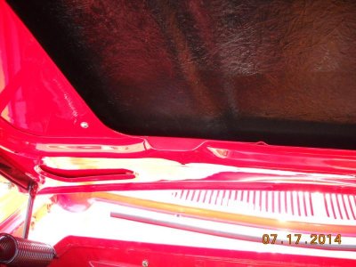

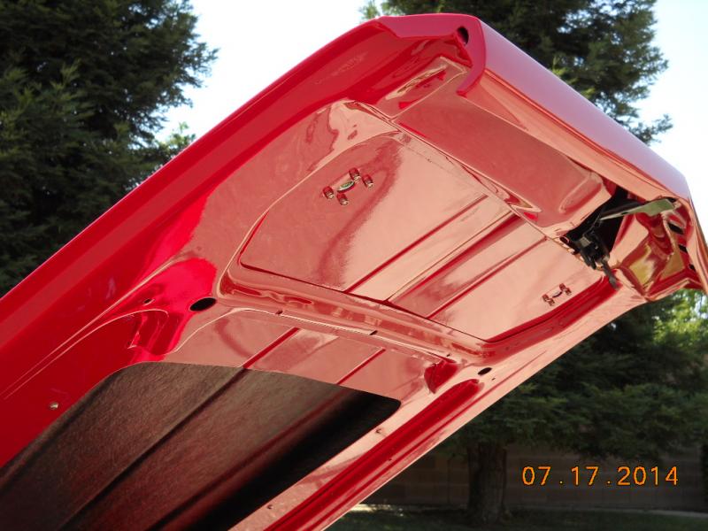

I ran my 63 Fury with the factory crossram, Edelbrock carbs and the aftermarket, stock appearing 13" air filters. I installed a torque strap to stop the motor from rocking because the clearance between the front of the driver's side air cleaner and the hood brace was about 1/4".
Recently I decided to add 1" spacers under the carbs to deal with the current crappy gas percolation issues, so cut the hood braces and added a later hemi scoop.
