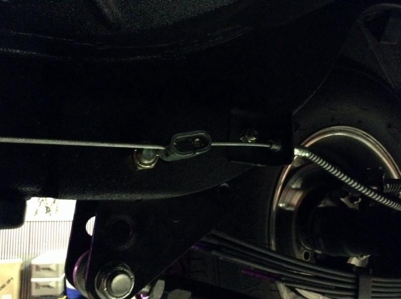

I don't have any exact pics but the one I'm showing has, in the center of the pic, pieces that are hooked on both ends. See if yours are still under the car. Somewhere in the center on the frame. The cable runs through these and if they come unhooked they won't take the slack out of the cable, just as you described...

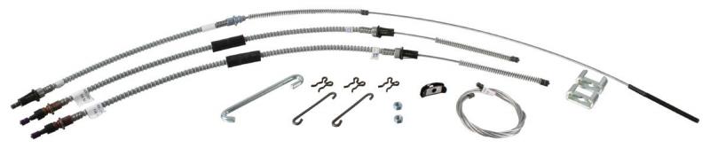

When I got my 63 all the parking brake parts were missing.I was able to get everything from the Right Stuff thru Jegs. The cable from the pedal goes to the trans cross member and snaps in place with a clip.Then there is a U shaped bracket that connects the long cable from the rear axle feeds. That cable has 2 supports on the body to hold them up.At the U shaped bracket is where your slack adjustment is made.They may have missed one of the locations along the way. Just a thought. Oh forgot to say the parts can be bought individual too.

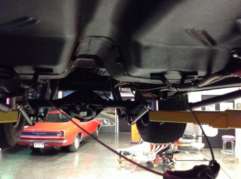

Bob, couple Picts of my '64 dodge. Same setup. The shot where you see the cable connected to the u-shaped cable saddle threads through the trans crossmember. Sounds to me like the main cable was not threaded through to body brackets. Assuming all the cables are connected from the peddle to the rear backer plates. And then connected to the activation lever inside the brake drum.
