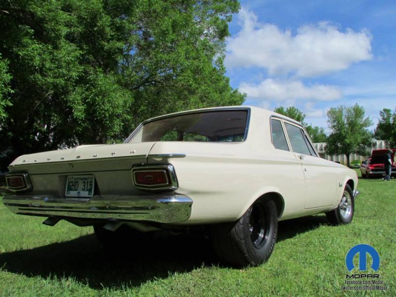

For stock wheel tubs we ran the 275/60/15's with a 7'' wheel that has a 4 1/4'' backspace.No rubbing anywhere.Usually you will find that a 8'' wheel will have a standard backspace of 4 1/2''.The 8'' may be close to the springs.Most of the time,depends on how high the car sits you may have the tire rub on the outer wheel house. Just a thought.

I run 15x8, 4.5" Backspace 275/60 BF Goodrich on the rear. SS Springs with 62-65 B Body front spring hangers and there's room for more.
Thanks. I do have SS springs but don't know what difference it makes. I think I will go with the 8 inch with 275/60's
Good choice with the 275's. They're taller (approx 28") and will fill up your wheel opening nicely.

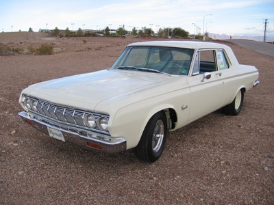

64Sportfury: How about posting some more pictures of your beautiful car? I really like it!
Thank you coloradodave. So as not to hijack this thread I will post pics under a new one.
