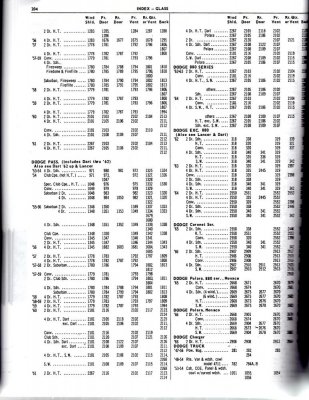

are these windshields the same? 2dr polara ht, 2dr 330 sedan. thanks 64
my friends got a windshield out of a 65 4 dr sedan in his 65 hardtop so i dont see why not but i could be wrong on a 64 but i think they to are the same.
Only the conv.is different!
Moparsteve: Please see the attached page from my Hollander Interchange. ALL FULL size Dodges in 64 shared the same windshield. The 880 model used a different windshield for the convertible, but neither one would fit the full size cars.
I think what Steve was saying was that they would ALL fit except for the convertible. ALL being the ones mentioned in the original post with no mention of the 880 at all.
What number is shown in the book for the windshield for a 63 Dodge 2 dr.ht. and what is the interchange? I have been told that 62/63 B bodies are interchangeable.
thanks everyone. i found a guy who has a good windshield from a 64 330. mine is cracked and i wanted to make sure it would work before i committed. i know my 56 ply. 2 dr ht was different from the sedans.

Red63440: The original post was for a 64. ALL 64 FULL SIZE Dodges use the SAME windshield, per the Hollander page above. 62 and 63 are interchangeable but different from 64. Whew........
Dave, the question was, "are these windshields the same? 2dr polara ht, 2dr 330 sedan. thanks 64" there was NO mention of the 880 or any other FULL SIZE cars until your response when the 880 was mentioned. The B-bodies were considered MID-SIZE. NO windshields from an 880 will fit a B-body. Not trying to argue just trying to compare apples to apples and not apples to oranges.
Mea Culpa. Semantics here. I consider my Fury to be a full size car and thats what I was referring to. Technically, it's a midsize. You're right. Regardless, convertibles in 64 were the same windshield as the sedans and H/Ts. Are we done?
Yes, sounds like we're on the same page now....:icon_eyes:
