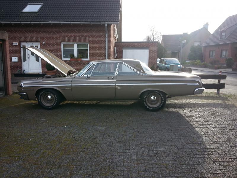

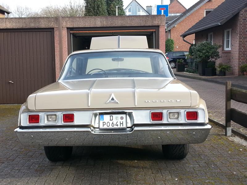

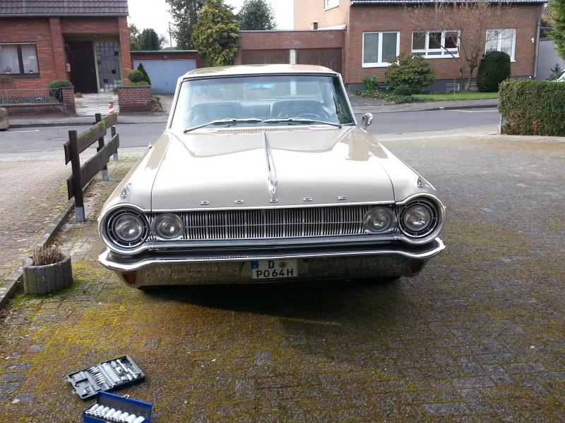

hello from Germany. Here is my 64 Polara 500

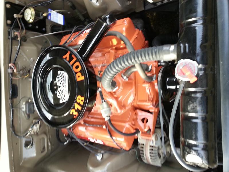

I am looking for some performance parts to kick my 318 Poly to raound about 300 hp. I would be pleased for a part list to fire it up:headbang: 20140215_154121.jpg20140215_154047 (1).jpg20140215_154101.jpg20140215_154010.jpg20140215_154032.jpg

Willkommen! Nice Polara you got there. For more power try and find an aluminum Weiand four barrel intake, TTI makes headers and I'd say 550 to 600 cfm's of carburetion would be a good start. Next would be head work ($) and a cam swap followed by a Paxton/Mccolluch supercharger. This was a set up I always wanted to do but a big block got in the way.
Seriously though, check out what these guys are doing as well.
http://chryslerpower.com/webstore/Poly
Welcome and a very nice Polara.
What do you think about the HotHeads intake from chryslerpower?
