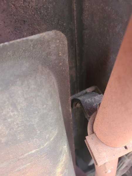

Can somebody tell me or show some pictures how the exhausts on a 64 b body should be attached?

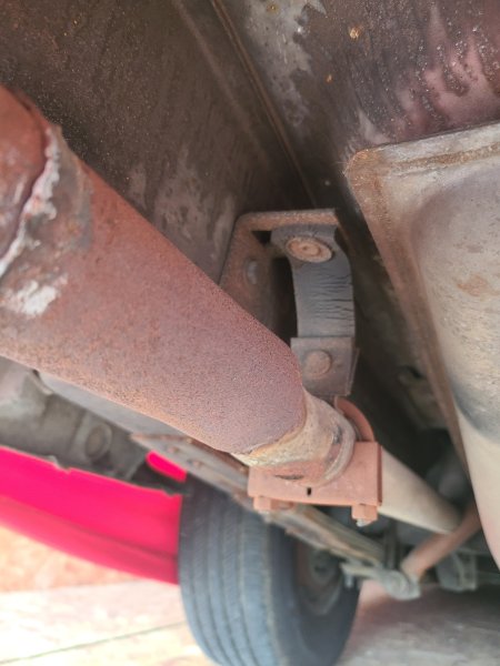

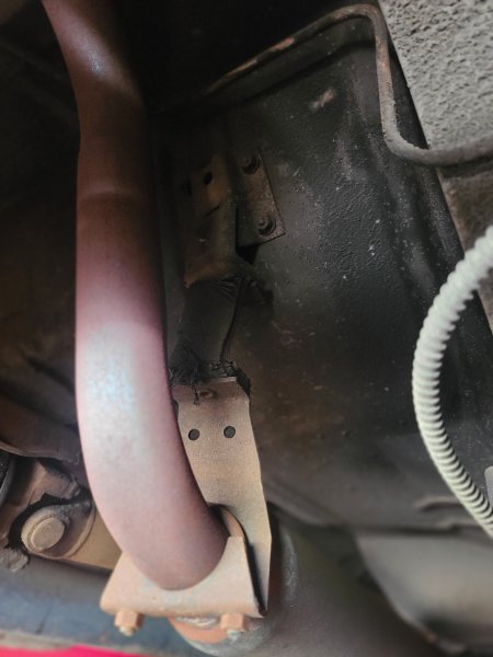

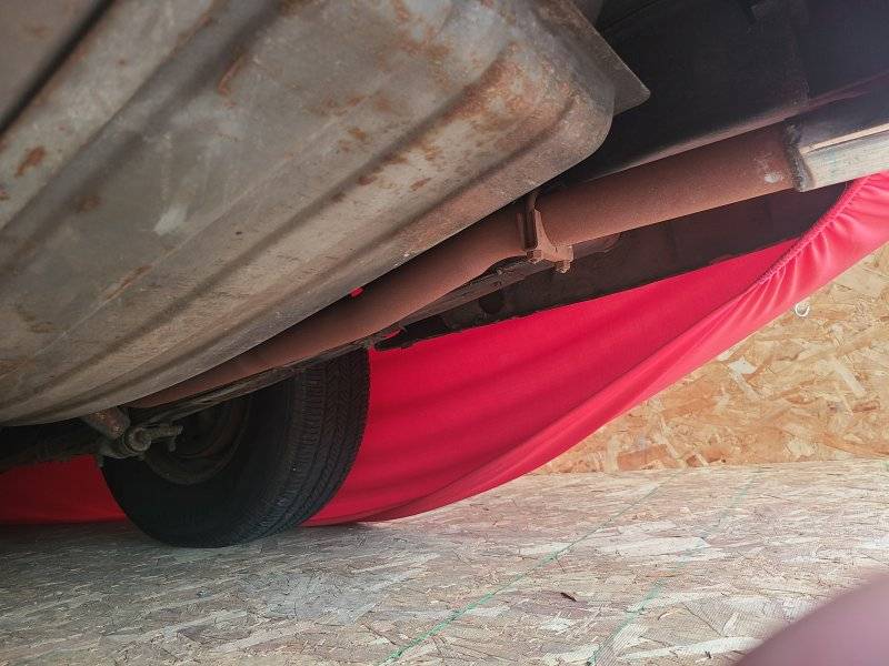

Here you go @Yennes this is what mine looks like. Best I could do laying under it.
Driver side rear:
Passenger side rear:
Driver side front of axle:
Passenger side front of axle:
