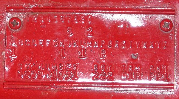

This one is a P which was odd to me. My 64 330 doesn't have anything under the P. It was built in Hamtramck and is a highway patrol car. I have seen a couple other tags on other websites with the P.
