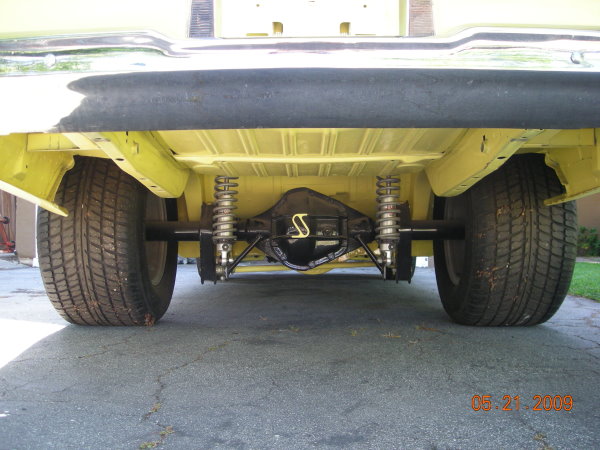

Here is a view of it done all the way just for reference.. Strange S60 (Dana) Chassisworks Prolink Setup and a mini tub.. I thought it over for a long time and then said what the heck and made it bulletproof !!!
