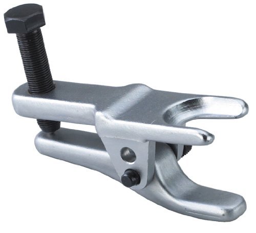

You can probably do it but I would strongly recomment one of these:
http://www.amazon.com/KD-Tool-Universal-Joint-Separator/dp/B003YVWHOE
I purchased one years ago and it has come in handy on everything from ball joints to tie rods.
