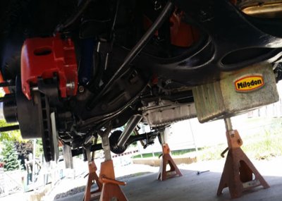

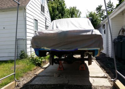

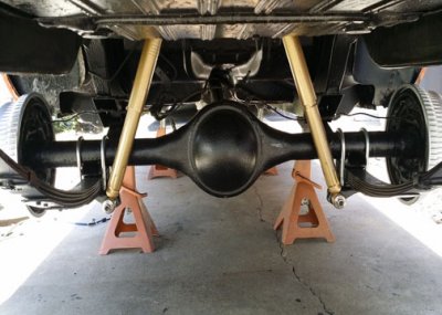

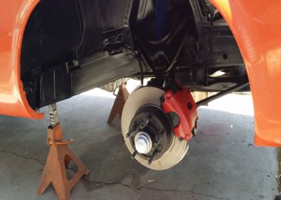

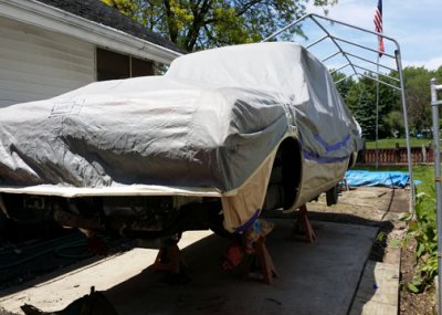

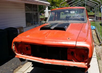

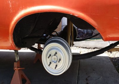

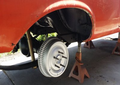

Purchased car last December, was old SS car not run for many years, so far cleaned and painted chassis, replaced complete fuel system, had old style two electric pumps thru manual fuel pump them regulator. New fuel tank, 3/8 sender, removed all stainless and chrome without breaking a fastener. Interior was almost completed by seller but I received all the rest of the interior stuff with it. Has 30 over 440 with dated crossram and dated 3705 carbs, 1 hour or rebuilt engine all good parts, including new stage 4 chry factory heads, also fresh trans and rear end. Next project wiring, updating trunk mounted battery with cut off switch, all new Pro Comp gauges and Pro Stock type toggle and light box. Car ran off the key switch when bought, gauges worked also wipers and all lights. Has radio delete and heater delete. Purchased new Doug ceramic headers had old style bent and welded ones like we ran back then. Has disc brakes up front. Old owner installed new 3 core Champion radiator, the fan clutch was way to close so installed Champion twin fan and aluminum fan shroud. After wiring done will go in for same color orange paint, also installed Max Wedge scoop that came with it, had a smaller one on it. Here are some pictures will send more detailed ones after wiring done. Having a problem uploading files will figure out and upload photos.

more pics, by the way it's in the garage now.
