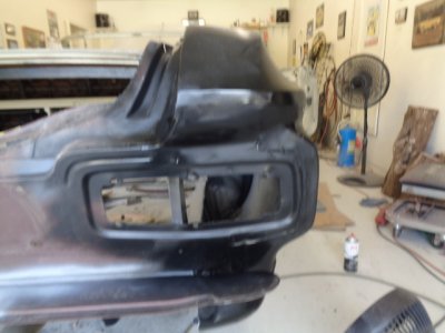

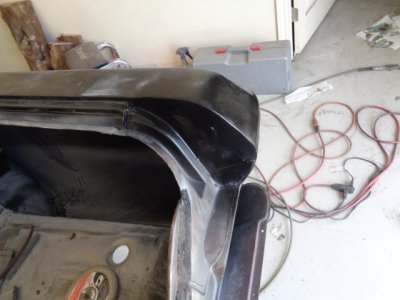

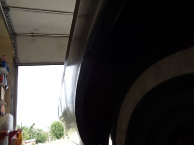

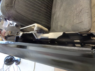

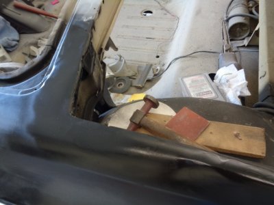

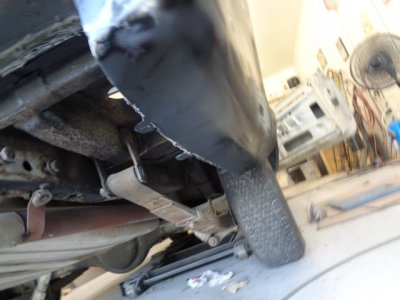

it's all spot welded in. there's about 200 spots around the panel. i have to do a little filling and sanding but the final fit looks good AMD 14 panel done 001.JPGAMD 14 panel done 003.JPGAMD 14 panel done 004.JPGAMD 14 panel done 005.JPGAMD 14 panel done 009.JPGAMD 14 panel done 006.JPG not bad for a first time it's a good idea to weld the quarter on when the car is on all 4 tires and not in the air because of body twist :VB toast::headbang:
