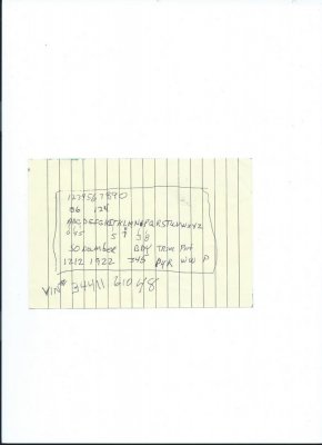

does anyone know a source for decoding the options on the 64 sport fury I'm going to restore for a customer. I have the #'s written down on paper in the correct order off the tag. thanks!
tom's 64 fender tag 001.jpg here's the #'s on the tag with the vin # I hope you can read it
SO NUMBER: 12 12= Scheduled production date of December 12, 1963. 1922=remainder of SO
BDY: 345= Plymouth V8; Sport Fury; convertible
TRM: P4R = Interior trim code = premium grade; vinyl buckets, red
PNT= exterior paint color = White. The second P means the inner upper door panels were painted red to match interior
AB/04= engine code = 361-2bbl
C/5= automatic transmission
J/5= heater with defroster
L/7= Unknown
N/3=unknown
P/8=unknown
06 and 124 =- gate and base numbers for producing the body in white.
