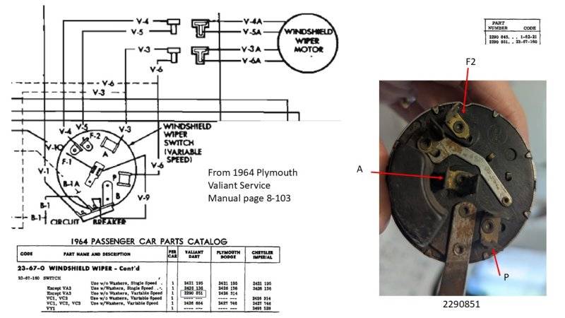

I am trying to test a wiper switch for a 64 Valiant (2290851, variable speed). I compared the connectors on the switch vs the wiring diagram from 1964 Plymouth Valiant Service Manual page 8-103.
The wiring diagram shows more terminals than are on my switch. Take a look at the attached diagram.
Can someone help me understand what is going on?

Looks like your switch might be for single speed.
I would agree with you, but a search on ebay showed all the 2290851 switches looks just like mine. My switch is stamped with 2290851. The book claims it is a variable speed switch. I'm confused. The switch is missing terminals for V-4 and V-5.

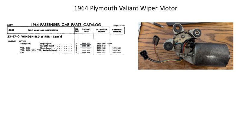

Another Mystery - I've included a pic of the wiper motor that is supposed to go on a 64 Valiant. Since it has 2 sets of wires, I conclude it is a variable speed motor. The motor is stamped ERQ-4006-12v 463. Is this the same as 2525 269?
