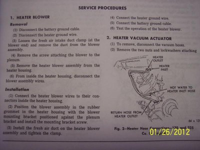

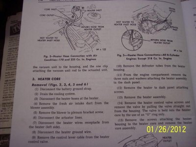

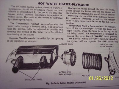

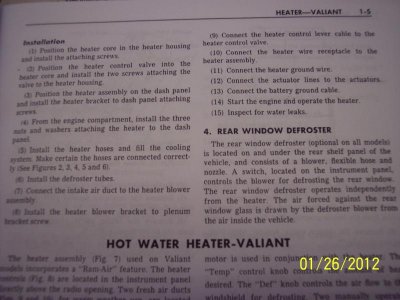

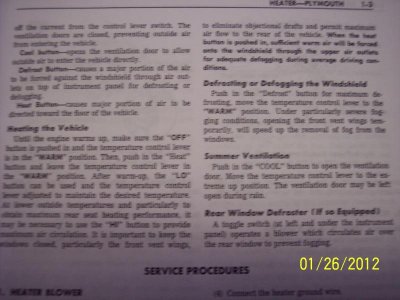

This is out of the 64 ply shop manual.1 picture is not the best but readable.
Hope this helps you out
Jeff
