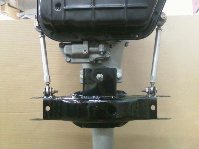

mine

Doug I like the looks of your anchor points on the tranny to the tranny mount, I am curious about this you must be running her hard.
Running a Motor plate. This keeps the motor from moving rearward. 64 Belvedere, 9.02@151, 3350lbs
Doug

I've been told NOT to use the trans crossmember,I still don't have limiters. What say ye!:icon_sunny:
If it runs a plate it should have limiters. Do the limiters cause any issues mounted on the cross member? Not that I've seen. Been that way for 3 years and 300 passes. I wasn't sure it wouldn't break the case when I built it, it hasn't. Out of the way. My entire trans assembly comes out as one piece, cross member, shield, and cooler lines.
