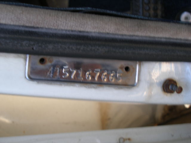

Thanks for the input guy's. The car has a Govier report where it states that it is a rebody, it has the correct heads, intake etc, date code block but no numbers matching anything. It has a vin tag RO51183033 but that may or may not be a repo as it is riveted on and apparently should be attached by screws. From what I can gather the owner who built it started with a copy of the buildsheet and built a car around it at a cost well over $100K and now claims it to be 1 of the original 101 built. As I'm on the other side of the world it's even harder to muddle through it, to me it's a clone, replica, tribute car or whatever other term you choose but not the Real Deal. The car went through Mecum's in approximately March, high bid $100K, May, high bid $80K, and September, high bid $70K, and who knows if those bids were real and is now for sale at $100K. I was just after feedback if any one knew of this car and what value a good clone is worth. Thanks for the input and all the best for the Festive season and the New Year.
The vin is riveted on , but a special rivet that has a hole the the middle.
I attached a picture of a vin from a 65 coronet that is ebay for sale. The car will have the SO number on the LH side of the package tray and the core support. Should also have the SO number on the fender tag, but the ones on the body would be the ones to look for. Darrell Davis also has a book for the 65 plymouths with the VIN numbers in it, and he can be contacted for further info on these cars as he is very knowledgable.

The tags are actually spot welded to the body, then polished over. No rivets or screws were used.

Learn something new every day! I know they did not use screws to attach the VIN plate with. I always thought it was a special type of rivet. Thanks for the info.
