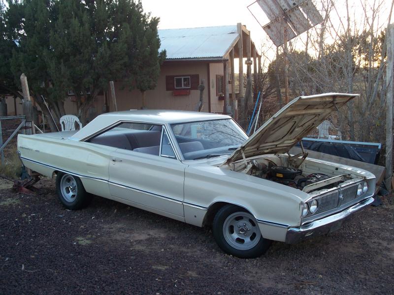

nice 65 its cool to see another slant 6 B-Body on here..heres my 67 Coronet 440 HT. /6 3 on the tree...God Bless.Bear R.-.

Just stock pistons, compression is going to be around 7.5. The copper head gasket will do the trick. Lots of guys just run low comp and lots of boost on stock internals. Thats a nice Coronet! I love those wheels.

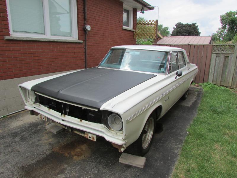

Just uploading some pictures!

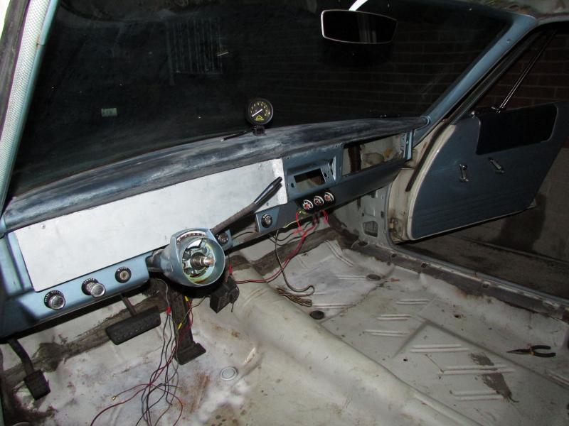

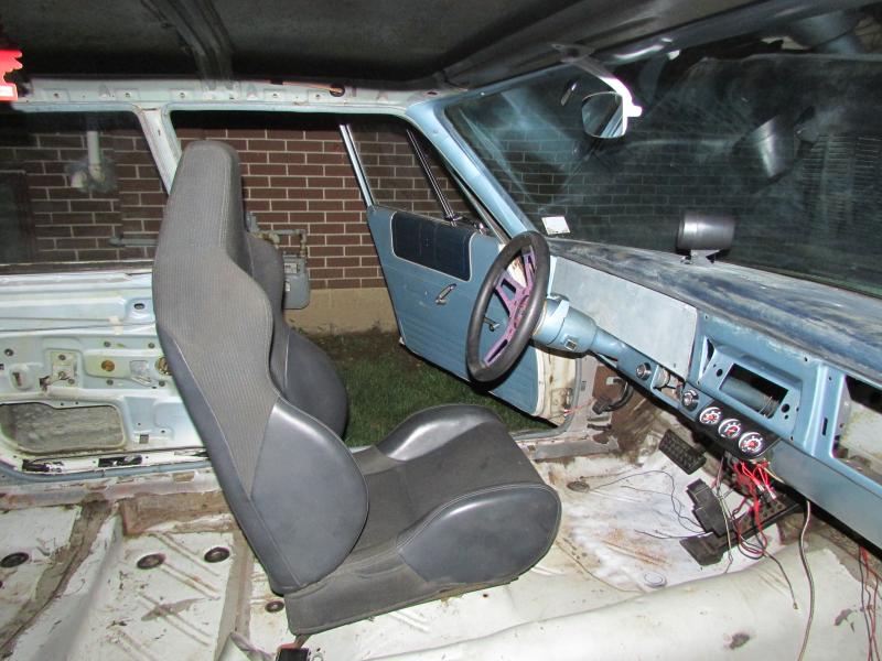

I'm running a single headlight and taillight to a toggle switch, and then my interior light and gauge lights on a separate one. Plan is to remove as much stuff as possible to keep it light and simple. Gauges I'm running are oil, temp, ammeter, tach, boost, and wideband afr. No speedo. Just ordered complete poly suspension bushing set along with new ball joints as well. Picking up a freshly rebuilt slant this weekend.

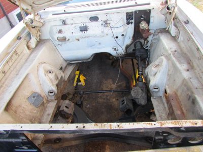

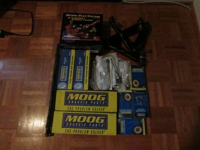

Got some goodies, and thanks to moparmark for sending the strut rods.
Should have it all on by Sunday. Also got front and rear sway bars off of my dads friend for free,
on the condition that when Im done with them, hand them down to someone else instead of selling
them. Next up is ordering SS springs and getting the rear end and tranny built. March 2014 is when
Im aiming to get her done by.

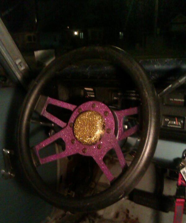

Got a seat out of an s10 and fit it in tonight, it's actually a nice seat! Also, ordered super stock springs tonight, the 3800 lb ones.

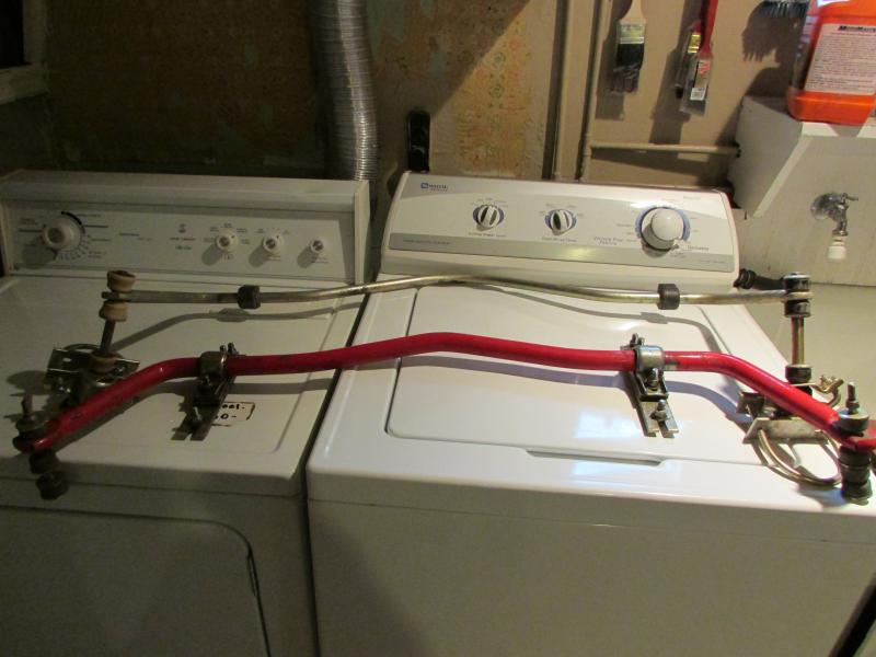

Got sway bars for nothing off of my dads friend on the condition that I have to use them, and when I'm finished with them to hand them to another person in need. Front is 1.18 inch, rear is 0.78 inch.
