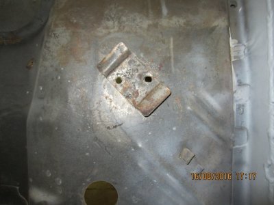

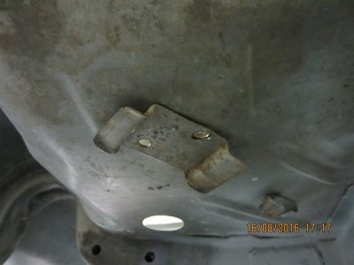

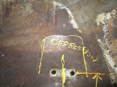

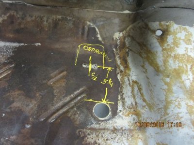

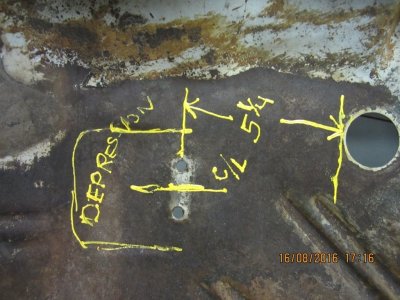

The driver's side floor pan was replaced in my 65. The holes for the gas pedal studs are missing. Before I start drilling holes, does someone have a picture showing the location of the holes in the floor pan?

Attaching photos of my 65 coronet. There is a depression in the floor just as it begins its vertical climb up. The bolt holes are centered side /side in that depression. The centerline of the two mount holes is 5-1/4" above the large hole on the floor. On the under side there is a reinforcing bracket.
