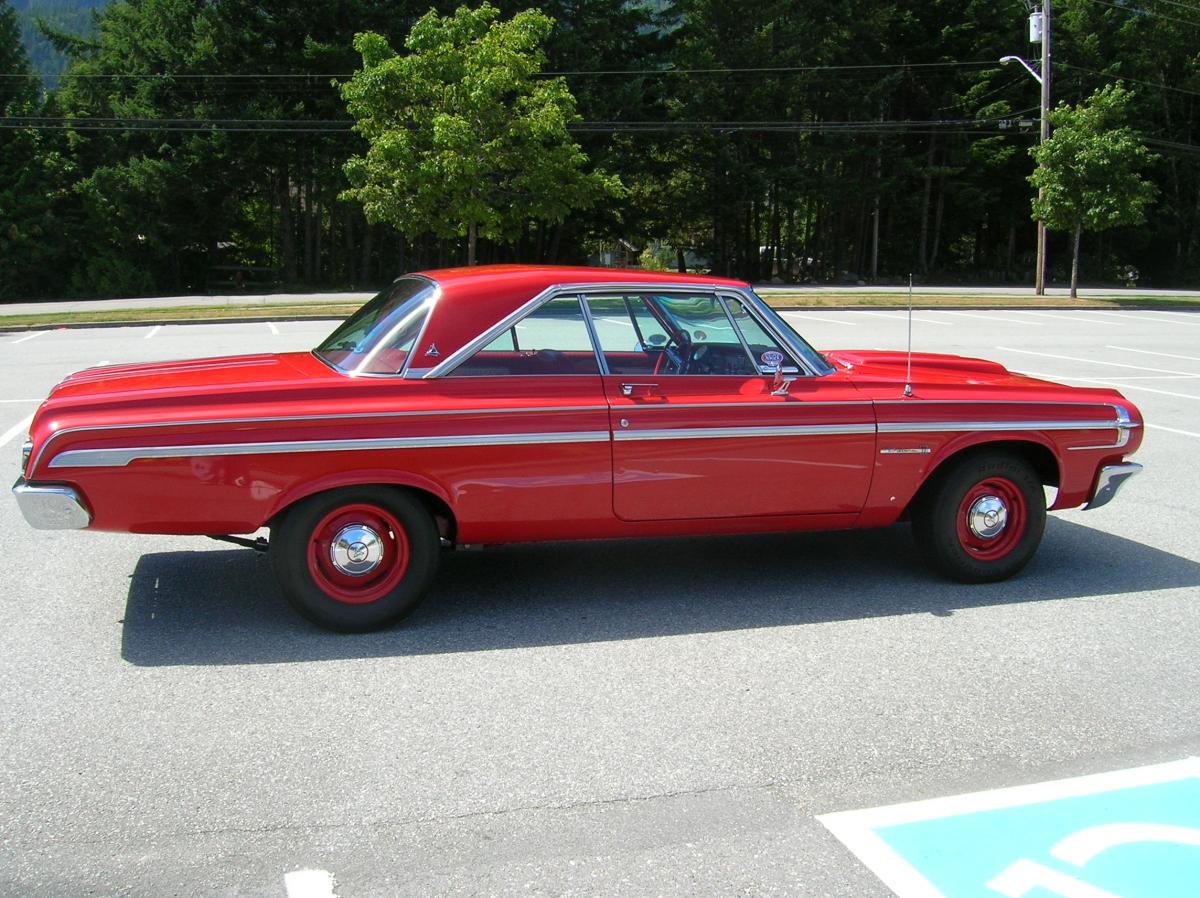

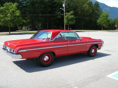

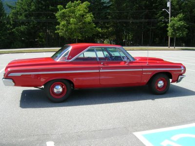

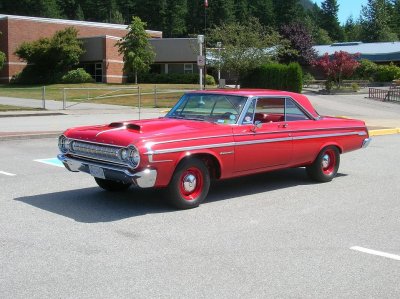

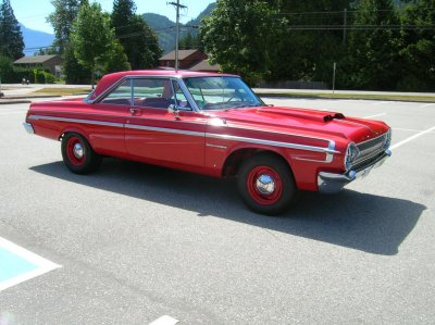

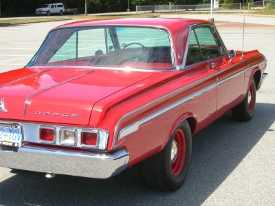

You're probably right to go with the 1" extra arch. The measurement from the ground to the wheelwell through the center of the hub was 26.5" on my Belvedere.
Super Stock Springs on 1964 Dodge
This is the ride height of my Dodge with the 3800 lb super stock springs, They have settled over the past two years
1964 Dodge Super Stock Springs
Ride Position

Thanks Don for the Pictures, awesome car!
I ordered my new leaf Springs today with 1" extra arch and 6 leaves.
