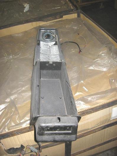

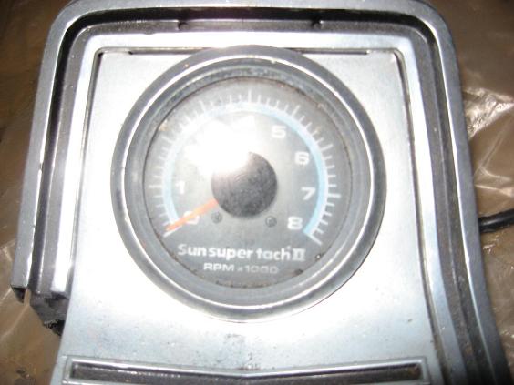

Hey guys... I am new to the awesome world of Mopar and have acquired my second love... 65 coronet 500 - 4 speed/383. The guy I got it from was an awesome dude and gave me a good price on it because I knew he dealt in old cars and he came across this one and let buy it from him. The car needs a paint job (I am stripping paint now) and a new interior. The car came with a console but it looks like someone has been doctoring on it :-( It has a tach (says "SunsuperTach II). I have been doing research and am sure the car had a tach in the console because my dash has a clock in it. I can post pics of the console but I need your help. I don't think this is the original tach and the console is missing the arm rests. I would like to put this back in with the new interior but finding stuff on consoles is very hard to do. Can anyone out there tell me about these "tach in console" units and if the clock in the dash means that for sure the console originally had a tach? I would appreciate any help on this. I am very proud of this car and hope to have it on the road this spring! :headbang:

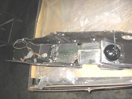

And here we go....the clock is a factory item, and so is a tach, but very few cars have the original still there, you can get one from classic industries. A wiring harness is also needed, seen a few on ebay before and yeah they are super pricey so is an original tach. Most console equipped cars came with a "decorative" plate to fill the hole. Any 64-65 b body console will interchange, dodge or plymouth, and 64-66 (i think) c body but those are longer, meaning they go to the front of the rear seat.
You mention you need the arm rest padding, I have seen some also on ebay.

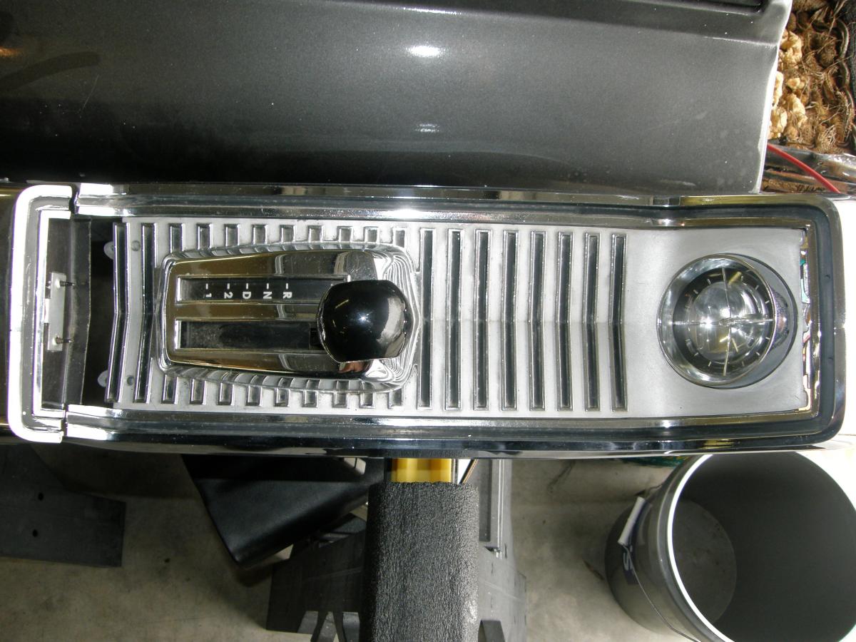

Here is a few pics of mine during the resto.

You will need the build sheet for the car to find out if it had a tach,that was an option!The clock was also an option. I have some consoles for the 64-65 b-bodies!e/m me with what parts you need!

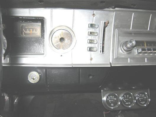

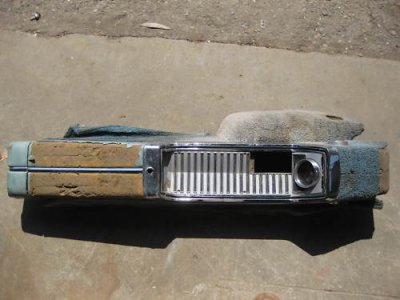

Thanks for the helps guys..... Here are some pictures. moparsteve-I will get a hold of you for parts and 5.7 hemi your console padding looks awesome!
You can see where someone cut the console but doesn't it have to be notched more towards the center? Is there any chrome piece I need to put back on the outer edge after the shifter boot (where someone cut? I am sorry guys... I got this stuff like this and just want to make it right. I have learned so much about this car over the months but this console is getting to me. There is just not a lot of information I can find on it.

They really cut that console up!!! It will be easier to replace it than fix.I can fix you up,so be sure to let me know!
I know man! It is a shame to cut something up like that that they make no more of. I fall asleep at night thinking the guy didn't know or was just not too sharp. It looked like he tried to convert an automatic over because I have the automatic plate that come with the car. I kept looking at the areas where he sawed on it and kept thinking that it was not factory!

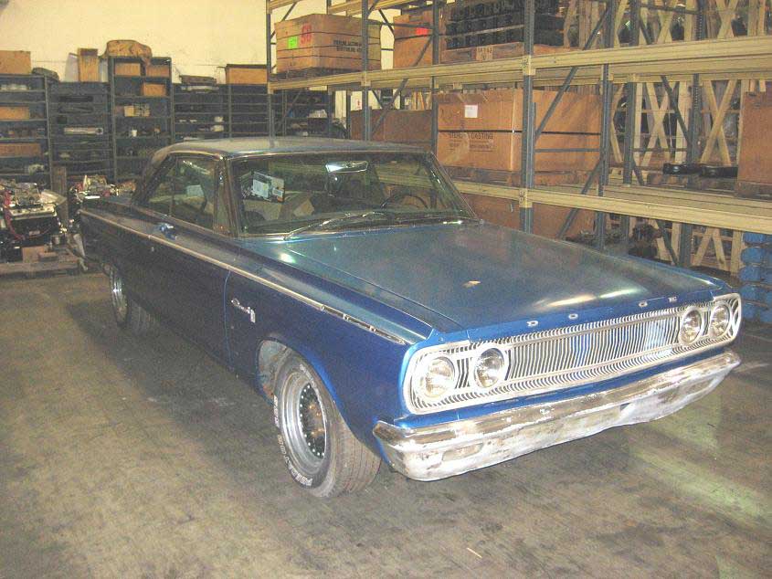

Here is a pic of her before I tore her all down for stripping.

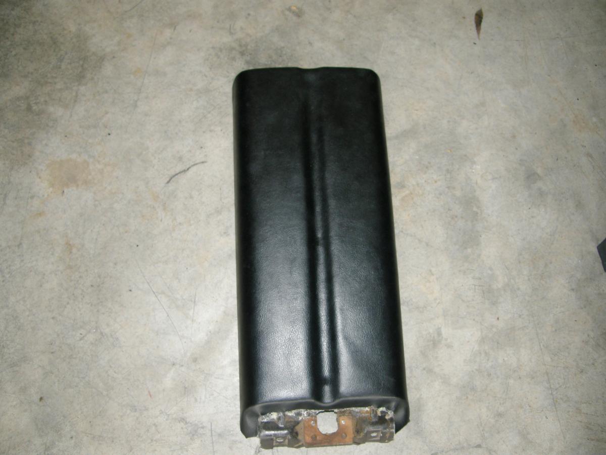

But I had a different question/comment. I just sent the center console lid off to Just Dashes to have the soft pad restored. The one on my car looked just like the photo posted here - soft foam covered with vinyl upholstery. The guys at Just Dash indicated that these cars came from the factory with hard molded and skinned foam pads, just like the armrests. Funny, but I have two console lids with black padding - both are covered in upholstry like the one in this posting. But I also have a lid with a white pad that is hard/skinned like the arm rests. Maybe the only way to repair these old pads was to cover them in vinyl upholstery?

Yeah the hard skinned vinyl is correct, but I could not afford to have it sent out and redone the factory way so I went with the vinyl, which matches my factory seats and door panels perfect.

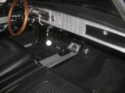

Attached, you'll find a picture of a correct 4 speed console with tachometer, as well as the console in my car. Note that mine has a vacuum gage (not original) in the console, and the boot is not correct. You will see that the left side of the console has a "bump out" for the 4 speed. That part is available as a repop on ebag. The 4 speed console tops are really pricey. I built one from flat stock which might look OK either painted or woodgrained like some of the full size Chrysler units. It is in no way intended to pass as a factory item, but should work out pretty well until you find an original. If you are interested in it, PM me.
