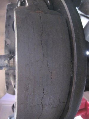

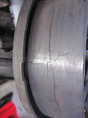

Still have a lot of shoe left but they are cracked...should I replace these?

it looks like they were overheated. personally, I would replace them along with freshly turned drums.
They are toast.... I would check the drums and weel bearings for wear and excessive heat blueing cracking etc....

Exactly... bearings, seals, hardware kit to include '69 and up adjusters, weel cylinders,and all 3 rubber lines then shoes and drums.... and check out the thread on ventilated drums I started on here.
