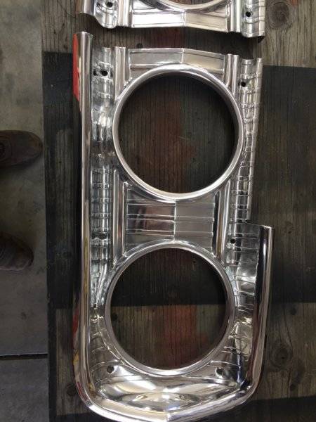

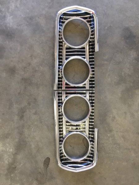

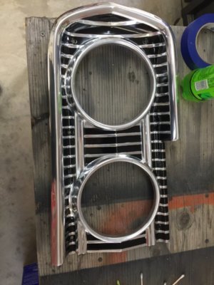

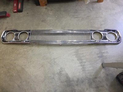

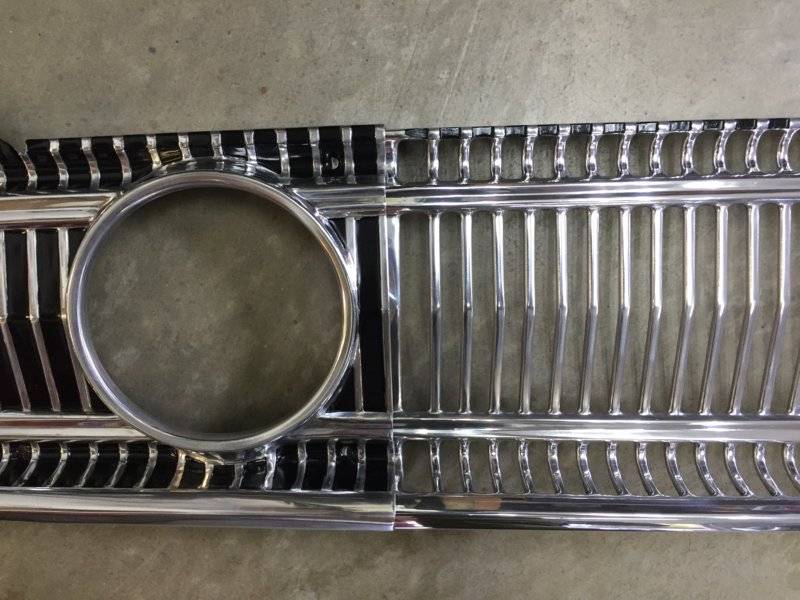

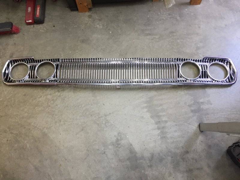

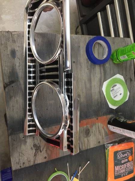

Just finished this for a FBBO member. Enjoy!!!
4F2B4344-DC33-455F-9873-14B4F014B1FE.jpeg 15C53614-3DCE-4403-972D-482441CCDD5D.jpeg 70960152-4A93-466C-839D-A6107EDA750E.jpeg C1DFE224-008F-4287-8176-B840031A57A1.jpeg F0ADAACF-5AF2-4CB7-A226-286B70EF9B03.jpeg 8F23351D-D231-493A-9DD1-0DEB7C711824.jpeg EDC907B1-D3E0-4A46-9528-529056EB0722.jpeg
Where are the before pictures? Looks better than new now.

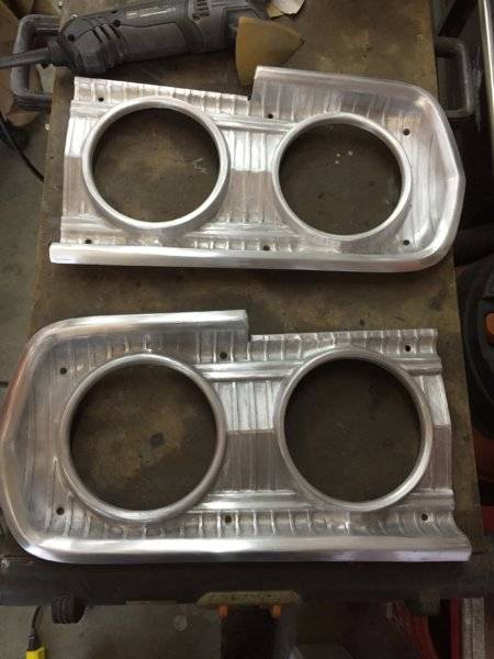

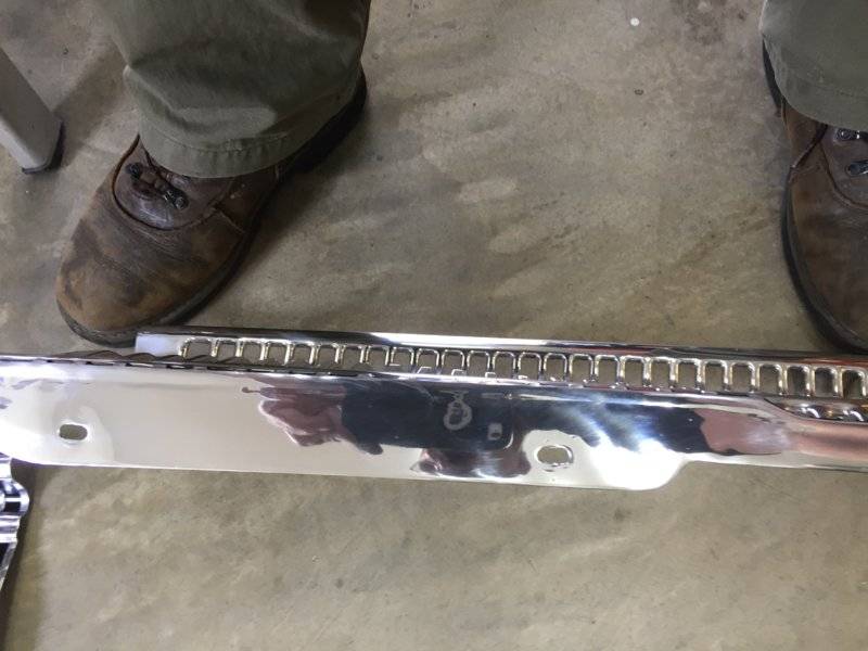

This is the only one I took. Here, the paint is gone and I’m sanding it after I fixed a few boo boo’s.
No. I don’t have the ability to have the brite dipped/anodized like the factory did. They are stripped and polished. I do leave the brite dipped/anodizing on the back.

There are products out there that will keep the polishing looking good. The paint work is what I am most interested in. My 66 Satellite trim was stripped and polished. I was unaware of this until to late, so I had to remove it again and after it was polished again, I sent it and had the anodizing done to lower my maintenance time. If I only had one or two cars to care for I could have stayed on top of it. Your paint detail is great, we may need to talk as I have some items that basically just need paint detail. My hands aren't steady enough to do that kind of work anymore.
