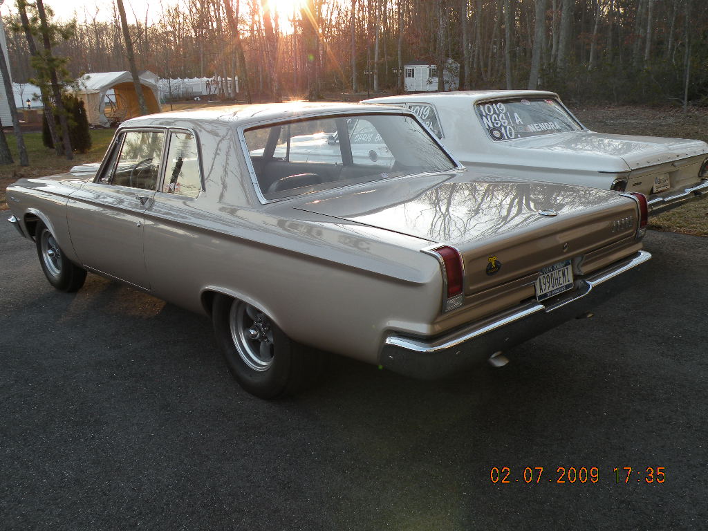

here ya go

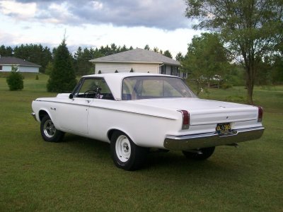

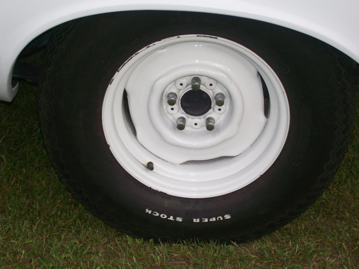

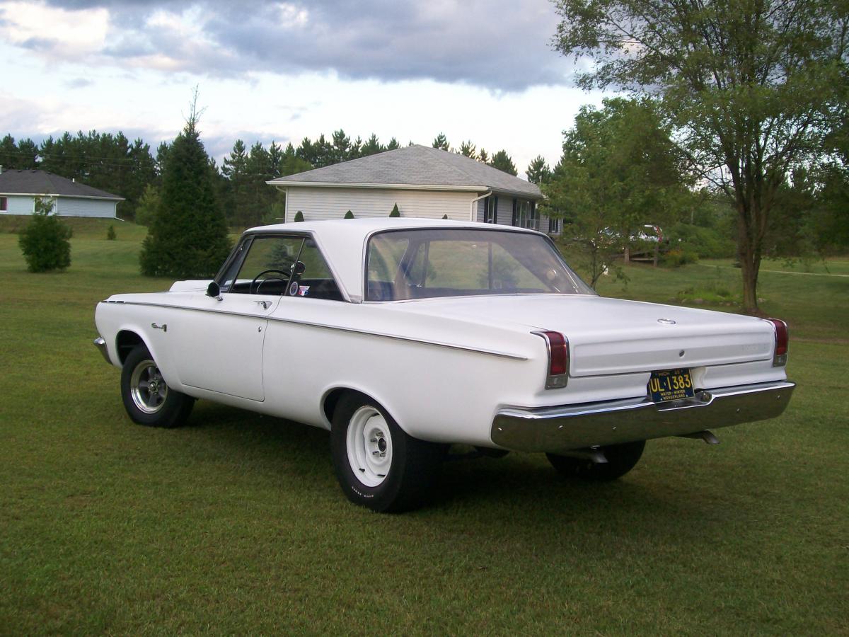

i'm running a nos set of formula1 super stock biasplys L60-15 on the rear of mine on a 15x7 rim 4 1/4 in, backspace but im going to change to a 15x8 rim with 4 1/2 bs so it will flatten the tread out more tire needs a wider rim basically.
