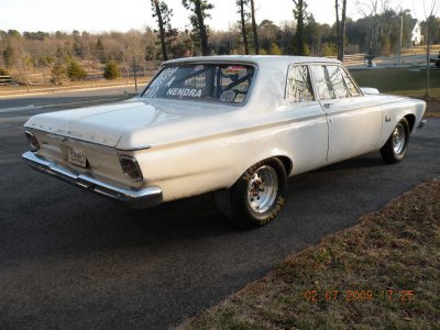

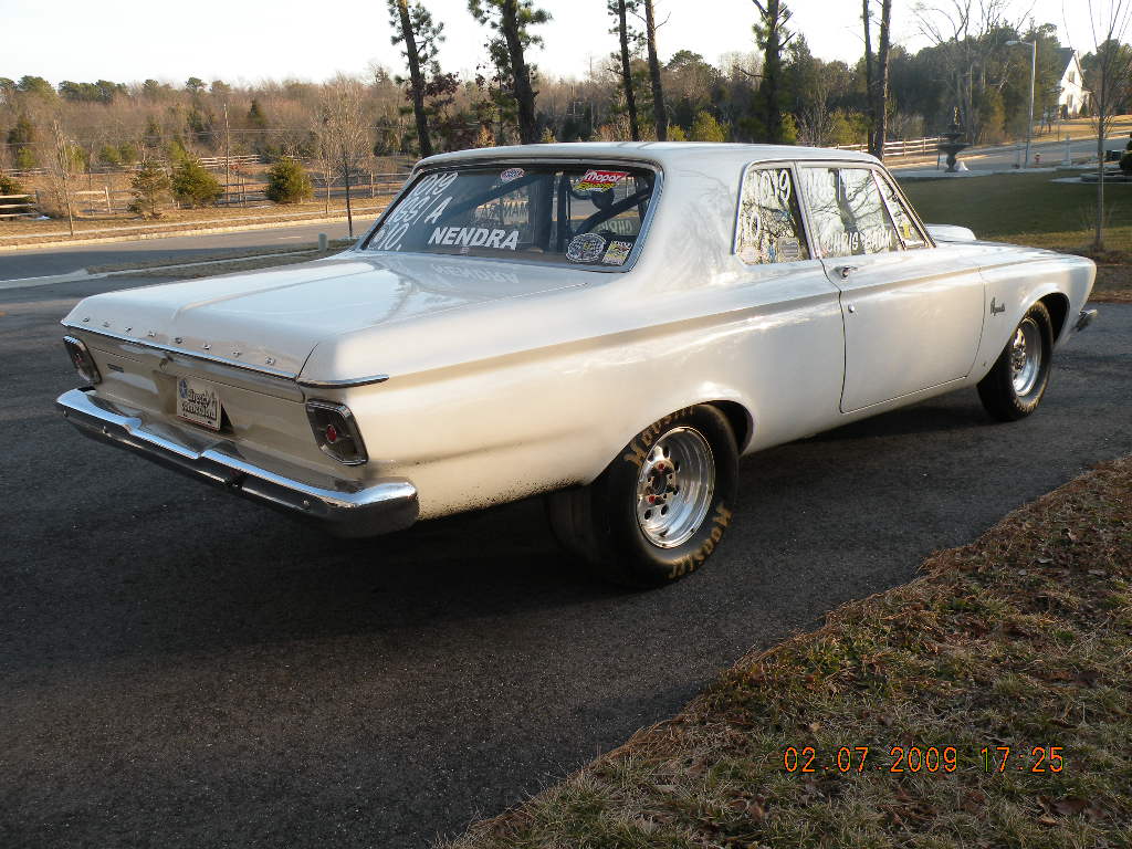

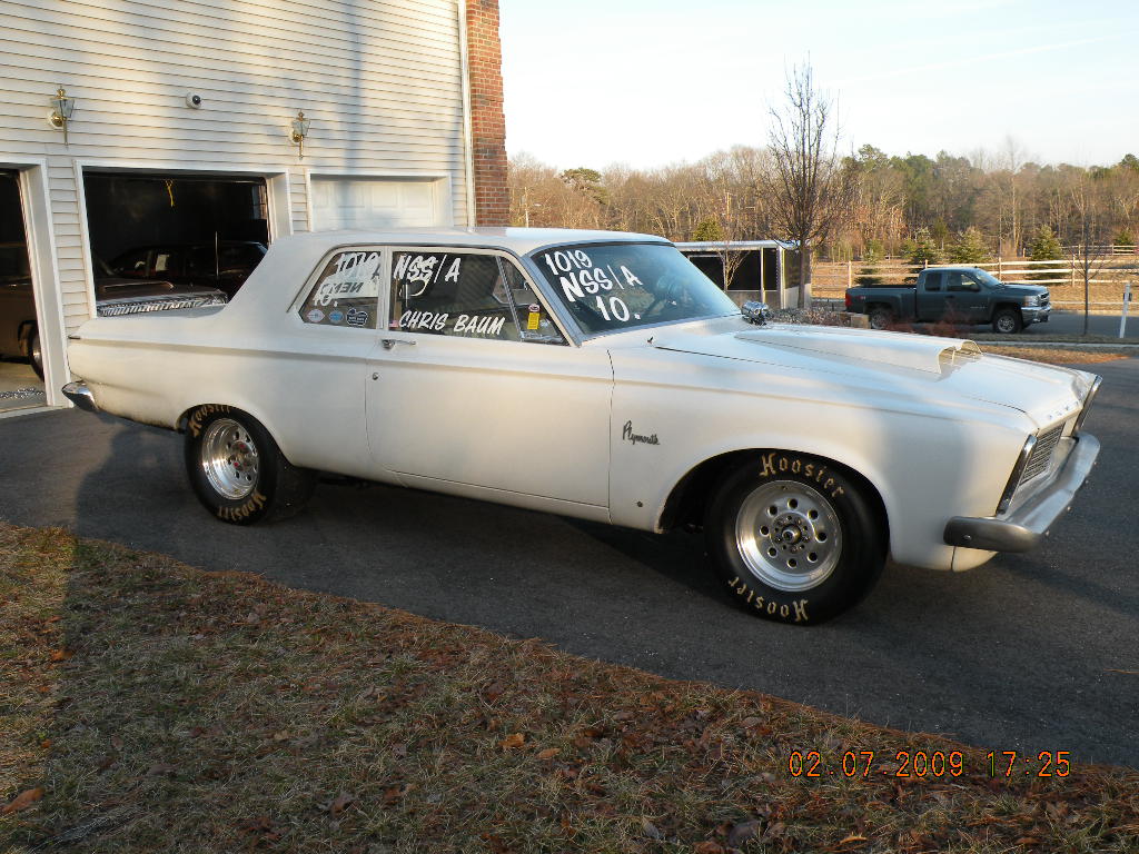

Heres a p[icture of my 63 plymouth not minitubbed.

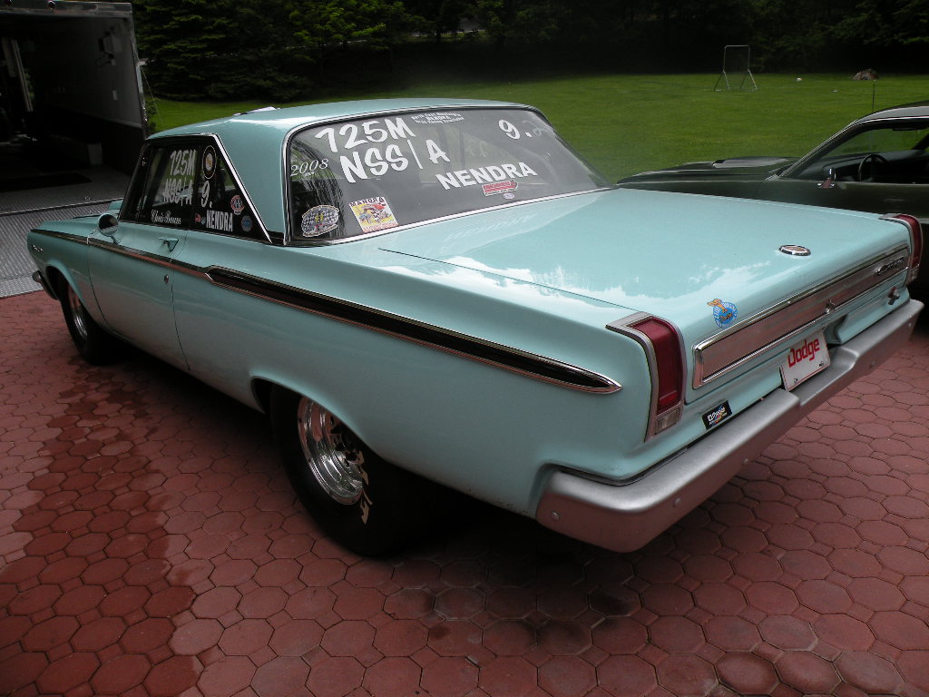

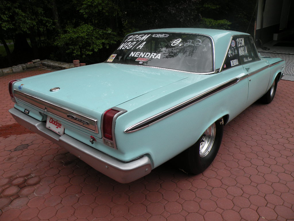

and my 65 dodge minitubbed for reference.

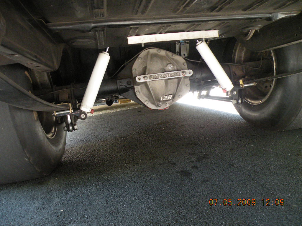

underneath shot.
obtw i fit a 29.5 x 10.5 non w under , but i believe with shocks you can get a 29.5 x 10.5w under there.
