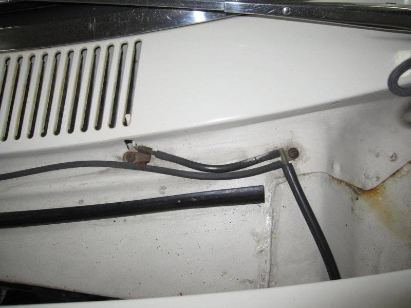

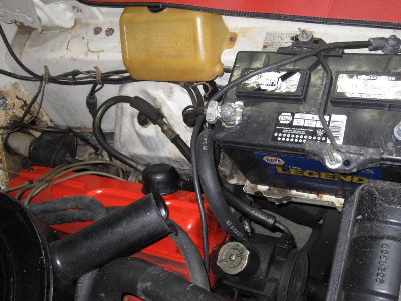

Well, here's a couple photos that may help. The hose from the firewall is most likely the vacuum source hose for the heater vacuum motors/diaphragms. It should source engine vacuum at the intake manifold. The washer fluid flows from the tank/reservoir to the pump (under-mounted on inner fender) and out of pump through hose routed rearward along with wiring harness and up to top of cowl to the splitter fitting. Joe Suchy may be able to provide parts for you. Good luck.

That vacuum hose to the firewall for the heater seems like it would be right. It's been a long time since I worked on something older that uses vacuum. How do I find Joe Suchy? And the lead wire to the pump, I can't tell the color in the photo. Plus is it coming out of the wire harness?

Are you familiar with the 62 to 65 Mopar site? Joe is a listed vendor there. The pump power comes through a tan/w. tracer lead run separate/alone from the bulkhead connector to the pump.
