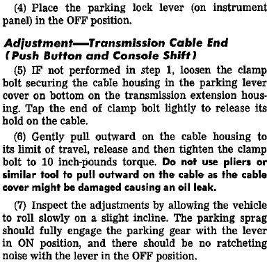

So I tried to stop the leak at my park cable but now have a bigger problem. I released the cable changed the O ring and put shrink tube on the cable. Put it back together, cable is snapped in. The leak was better but when I moved the car I get a loud clackety clack coming from the trans. Only does it going forward. I shut the car off put it in neutral and rolled downhill and it still makes the racket. It’s definitely rotational and increases with speed. Any ideas???
Park cable needs to be adjusted.
Thanks, that did it! I guess it was pushed in too far. Pulled it out a little and all is good. Sheesh that cables a pain in the butt
