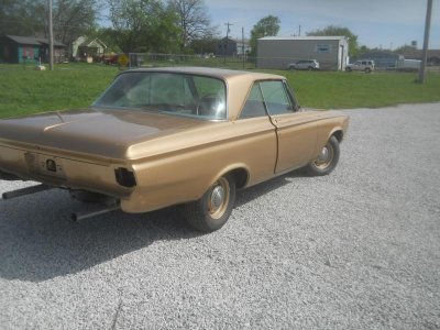

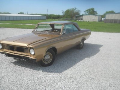

it's out of the booth and tomorrow I start the color sand. I use a da sander with 1500 grit to start and the uo to 3000 grit and buff out 001.jpg002.jpg003.jpg004.jpg005.jpg006.jpg007.jpg008.jpgwith a foam wheel at 1600 rpm's. the pictures are outside the shop :eek:ccasion14::headbang:
