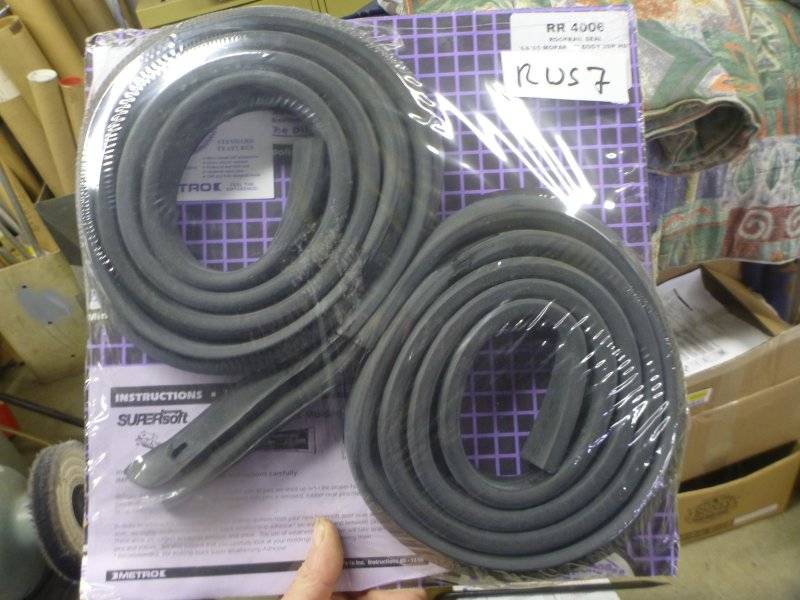

Wow....these are over double the price of 66 and up...
seems wrong...LOL

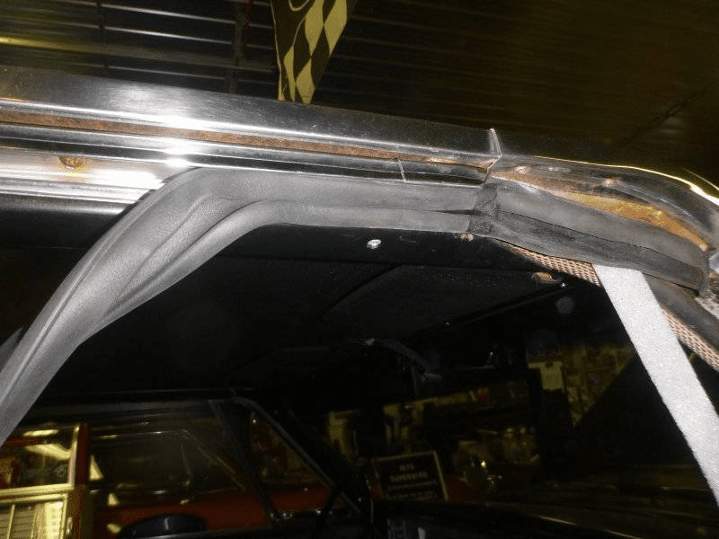

Always the way!! If you go with these Supersoft, make sure you spray some soapy water into the gap when you roll up the rear glass, so it goes INSIDE the U and doesn't pinch it down. Otherwise it's a fight to get them back on track. Rear 1/4 glass should be up in the U and then the door glass just closes against the outside of the weatherstrip.

Steel Rubber makes the correct seals. I purchased the "economy" type for my 65 and had to cut the angle in the rubber to make the glass seal. Still not perfect.
