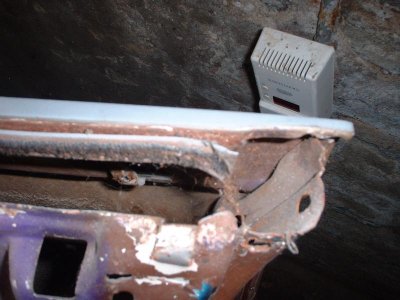

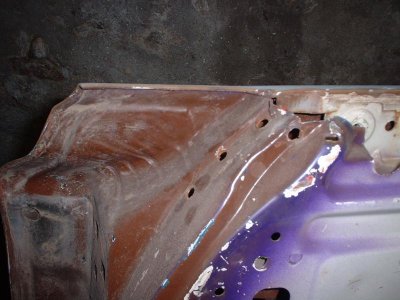

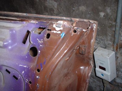

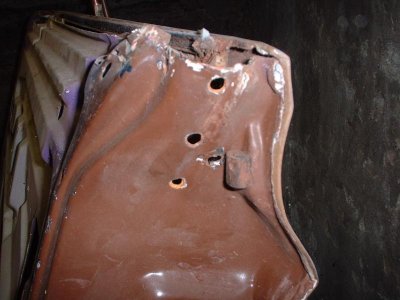

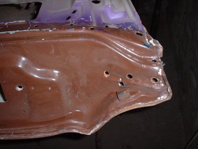

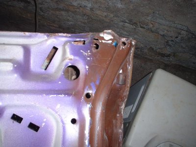

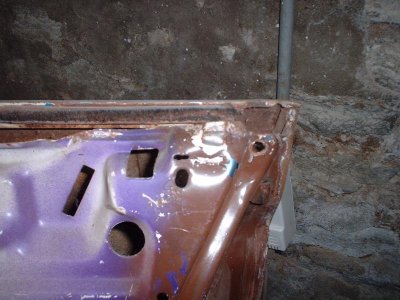

I need some photos of a 65 sedan door where the window frame attaches at the aft side. I'm converting a hardtop door to a sedan door. I have a sedan window frame that i'm trying to mount to the hardtop door. Looks like the frame will just slide down into the door at the front, but at the back it will not fit. If I had some photos of a sedan door I can probably modify my door to fit the window frame.

ow frame.[/QUOTE Here's a 2dr door sedan - the window hoop.

Well, looks like more work than I thought to convert my hardtop door to a Sedan door. Looks like I need to learn how to use a metal shrinker and stretcher, or find a junk 4 door car and cut out the pieces I need. Thanks for all the photos.

Thanks, but I got it figured out. A little precision cutting and grinding. Got both sedan window frames mounted on my doors.
