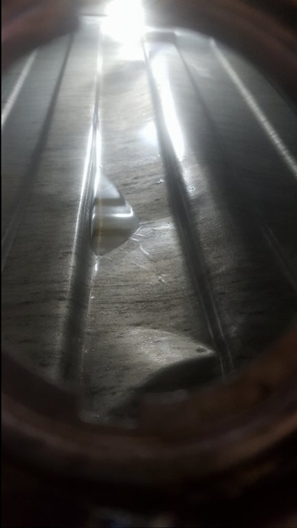

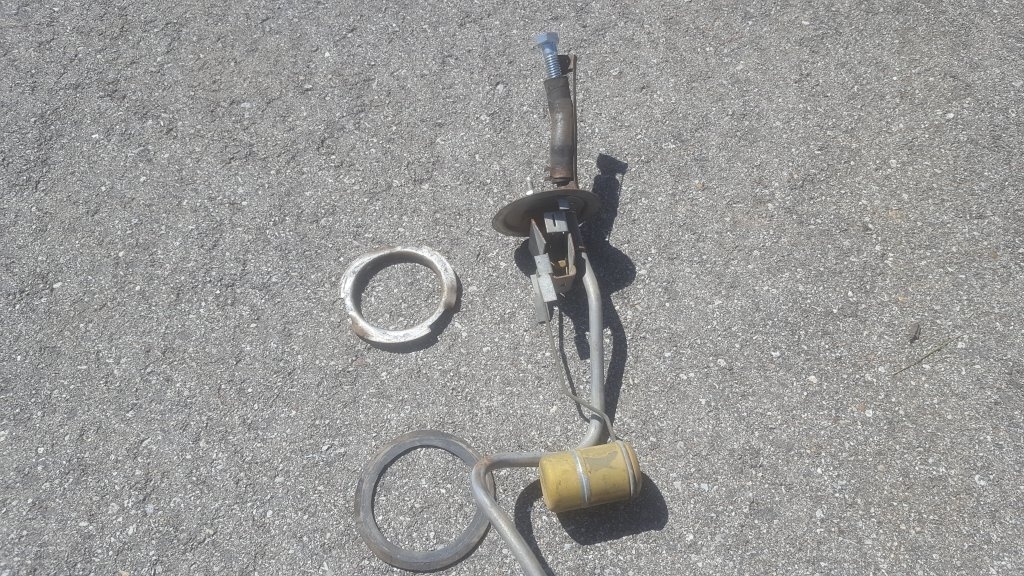

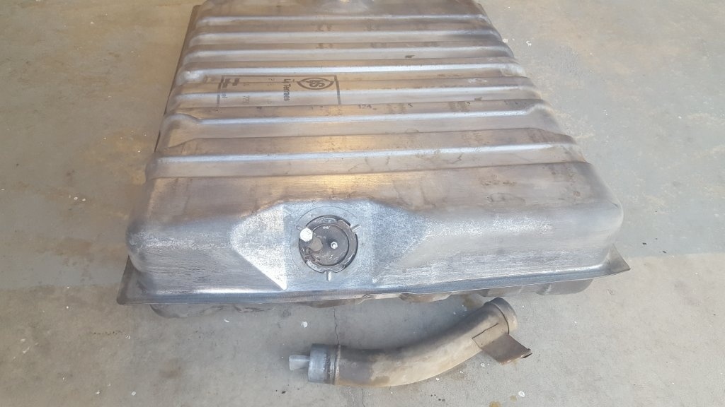

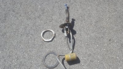

GREAT ADVICE from our fellow members, (Thank You Thank You)!! Taking out this tank was like falling off a log. This car continues to amaze me . This is the original 52 year old tank and sender! Other than upgrading to 3/8 all the way through, none of it would need replacement except for the tank neck grommet. Inside the tank is spanky clean. A lot to be said for California Cars!! Thunder

That's quite amazing!
You saw the inside of mine in my thread! And mine was born and raised in California. Last tagged in Oregon.

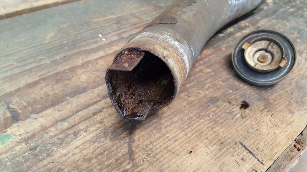

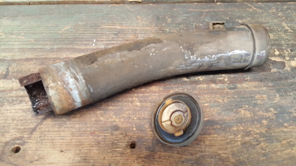

The '62 filler tube is different than the '65. The bracket is different and looks like it has a rib on the outside. Look how bad mine is rusted, ordered a new one.
Yes I remember! It looked like someone poured Roofing Tar into it! I was expecting same thing! I consider myself very fortunate. All I need is a grommet, and a 3/8 sending unit.
