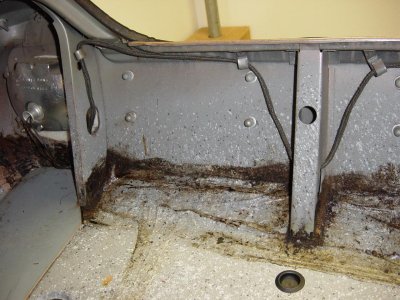

I believe that in '65, the inside of the 1/4 panels were undercoated and then sprayed with a gray/white speckle paint. How rough was the undercoating/soundproofing? What about the wheel wells and the area between the taillights? I am trying to make mine look stock, but not necessarily restored.
You are correct. On my '65, the 1/4's had the undercoating, which was not "dripping thick" but had a build up, then splatter paint. The trunk floor, and rear body panel were covered. The trunk hinge braces are coated about half way up from wheel house and the diagonal brace behind seat also is coated.

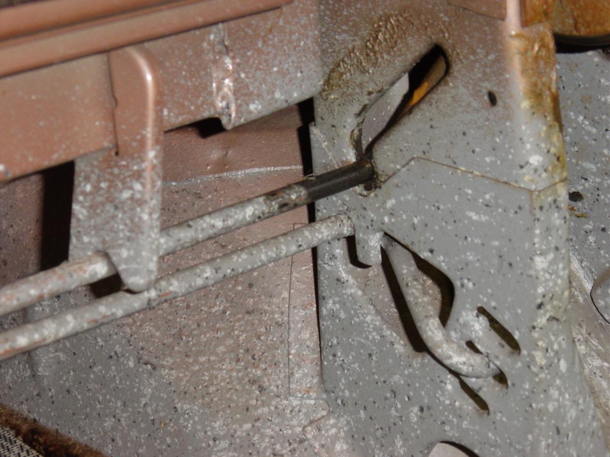

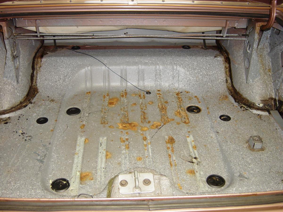

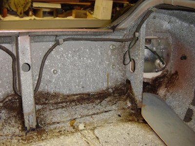

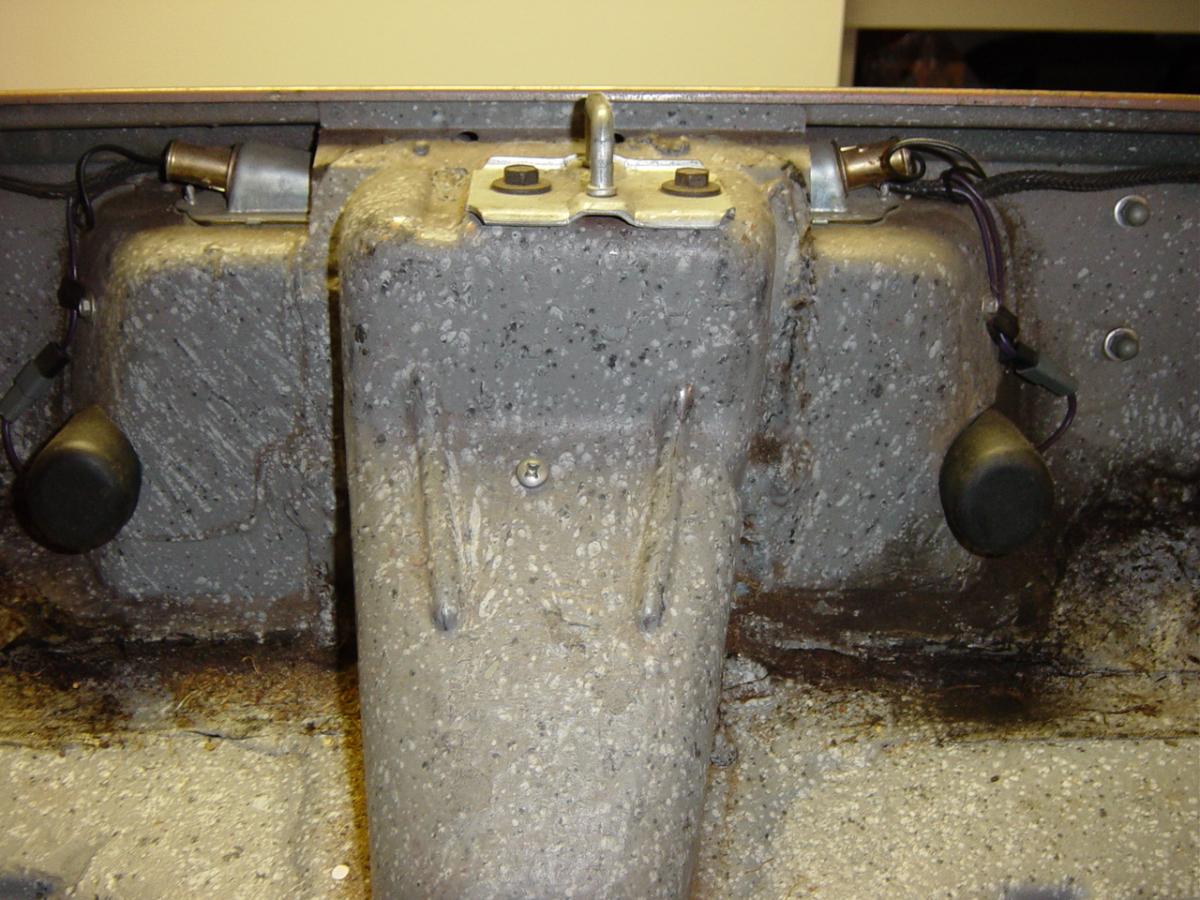

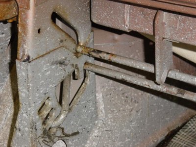

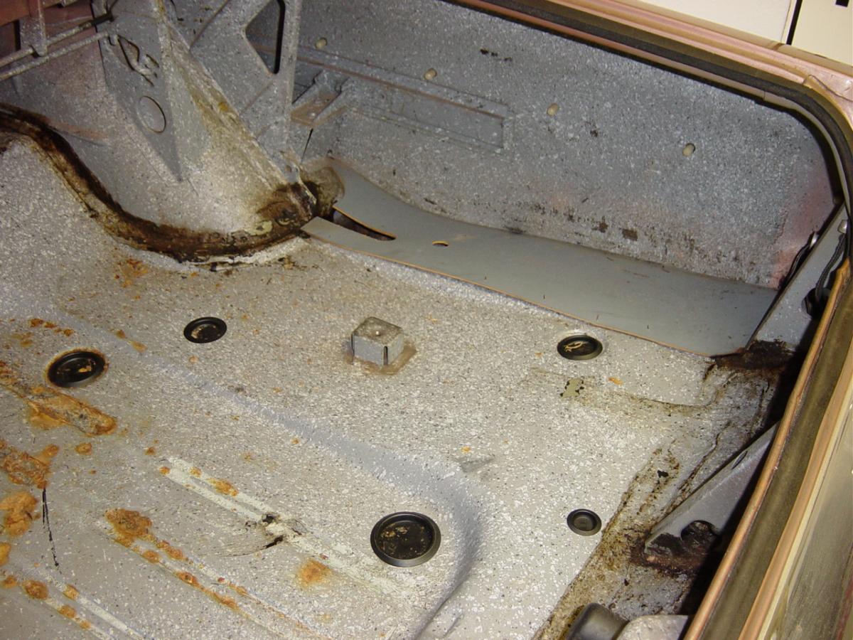

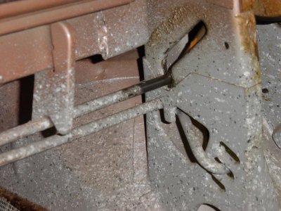

Here are several shots of an untouched 65 Belvedere II convertible trunk. As you can see, this stuff is fairly random - hope this helps.
Arland

Fantastic pics. Thank you. Looks like it was applied over gray primer or bare metal except where the body color oversprayed? Now I just need to find out where I can buy some.
