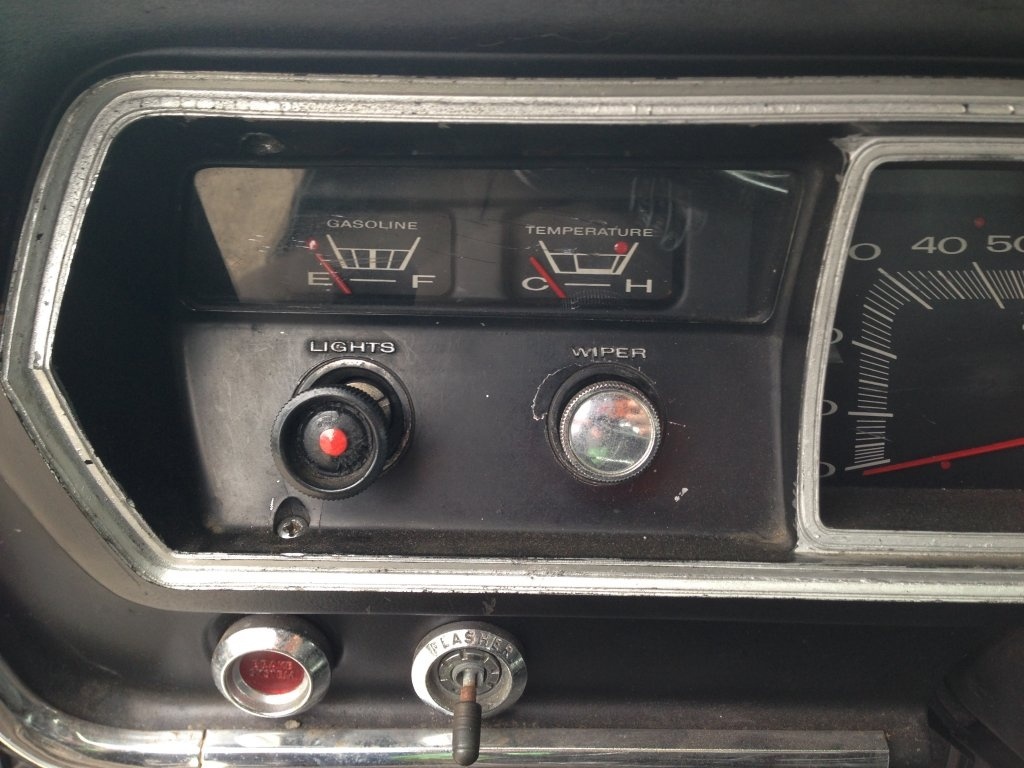

It seems that some had the headlight and wiper switch in the instrument cluster and some were below the cluster in the dash frame.
I'm trying to find out which years and trims packages had which?
All I've seen are in the cluster.
Dodge dashes are VERY similar, sheet metal wise, possibly identical, except- the headlight switch is in the metal dash.

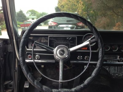

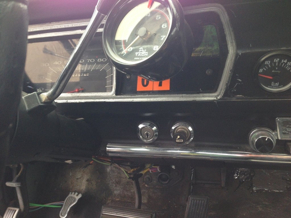

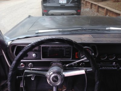

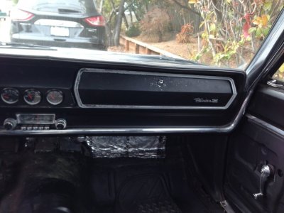

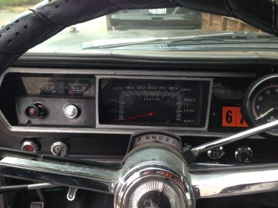

Here are some photos of my 67 Belvedere II. Cluster is stock (Tach is blocking oil pressure dummy light and ammeter). I also removed the a/c and heat controller which was where my tach is now. 3 center gauges went where a vent for a/c used to be. I did paint my gauge needles. They needed a touchup when I rebuilt my gauge cluster.
Go on ebay look for 1967 Belvedere in Ebay motors you'll see show me cars and trucks, click on cars and trucks. There is an ad for a 67 GTX the one for $119900. Look at dash pic looks like yours, only yours is painted? around speedo. The dash has the same stuff next to the left of steering column.
One question is that red light to left of column for brake balance warning?
E-brake and brake warning light.
I think the guy before me did paint around my dash with that silver. But I thought he just touched up what was factory, could be wrong though. It's an LA built car, and californians love there "dealer options".
