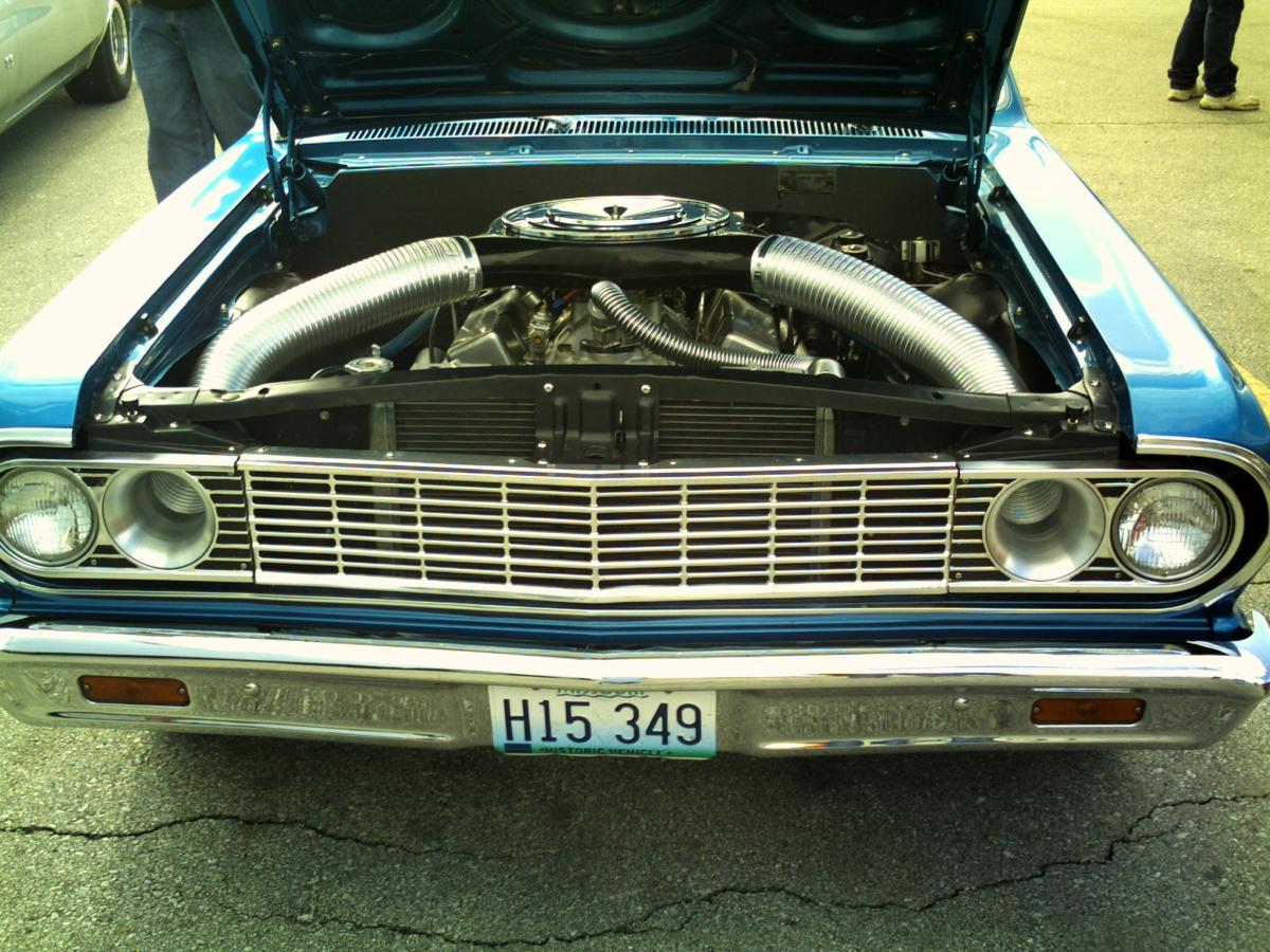

I know the difference is the parking light 66 and the larger headlight 67 but are they the same fit? What I want to know is can I run a 67 grille in my 66 so I can run my ram air set up like I had on my other car (see pic)

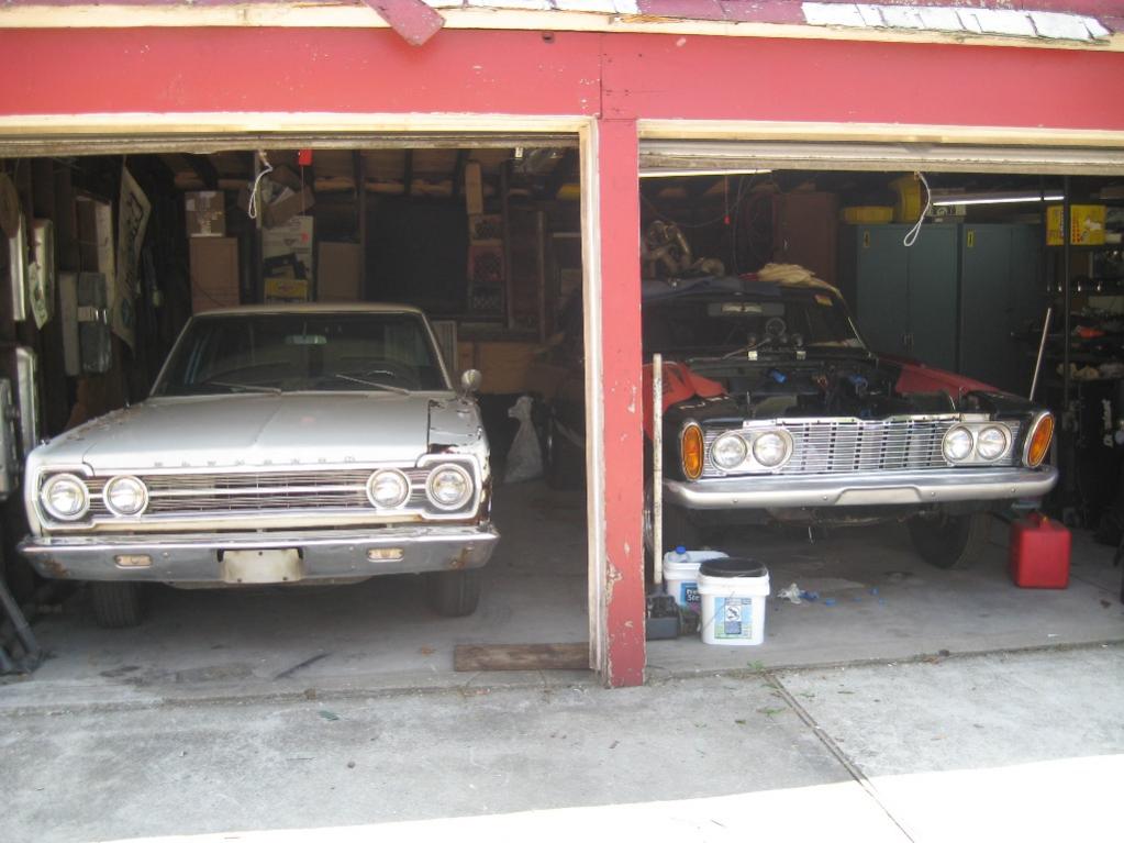

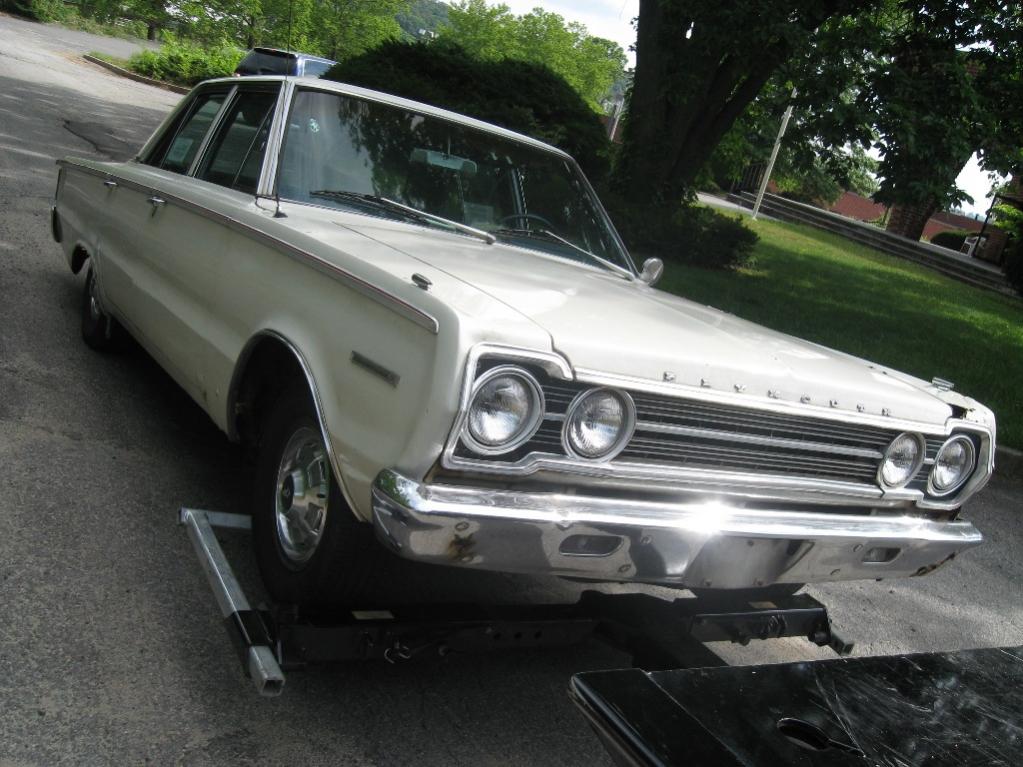

My buddy has a 66 belvedere,I have a 67 GTX...They are different,i don,t think it,ll work...
Petty Blue 67 GTX
The grilles are not interchangeable unless you change the fenders. Learned this the hard way.
Didn't realize there was that much of a difference...wow. I also thank you for the pics. I've had a few 66's but never a 67...or a least one that had a front end on it...

In case no one noticed the first pic is a 65 Malibu.

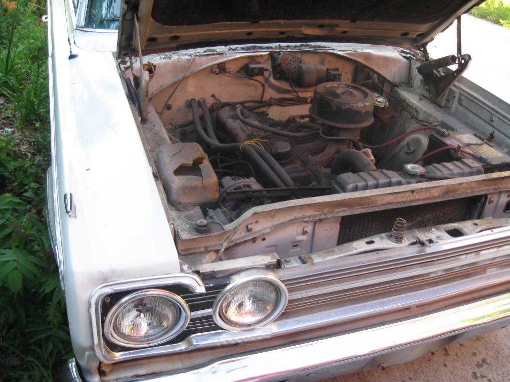

Headlight "bucket" would be different as well.
Not sure about Plymouth, but Coronet fenders had bolted buckets one year and welded buckets the other. Fenders can swap but there is cutting involved and maybe welding.
I do like that induction system.
Looks liike you'll have to cut the core support/radiator wall anyway.
The headlight buckets are welded on 66 & 67 plymouths and they are different. Also the part between the grille and the bumper is also different.
