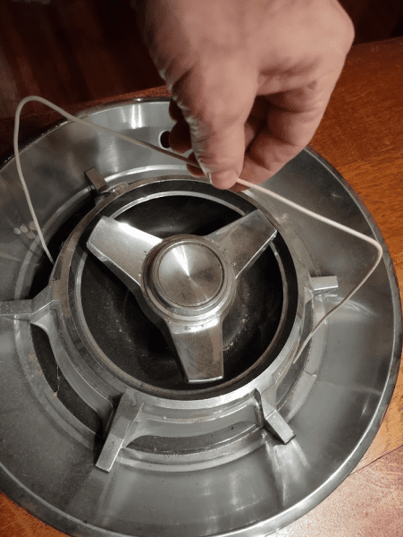

Looking for some information about 66-67 Charger Spinner Wheel Covers. Could somebody that has one of these wheel covers please measure the outter diameter of the center bowl/housing ? not clear out to the 6 spokes, but back to the main center outter diameter of the housing. Sure would like to know this dimension..Thanks. To clear this up. Just want sizes of the cast part...not the stainless trim ring section. I'm thinking it's about 10" in diameter ? if someone could verify that, if would be great. If I had one I would measure it myself.

I get 9 -3/8" on the middle piece back to the flat black area.
Thanks for checking that out for me...sounds like there's a chance a 9" dog dish may fit up inside the spinner casting.

This is how I measured it.
