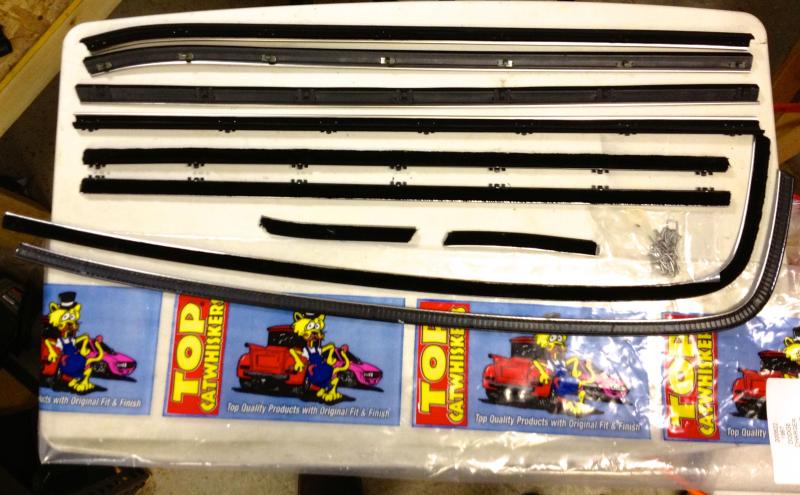

Here is something I learned today: The Window Felts (Fuzzies) for 66 & 67 Chargers are NOT interchangeable on the rear quarter windows.
1966 uses 4 long "J" shaped pieces for the bottom window channel - 2 per side. It's uses an 8-piece set.
1967 uses 2 long pieces with a slight curve at one end, and 2 short pieces for the rear (vertical) section of the window opening. It uses a 10-piece set. (see photo, the label on the package says "1967 Charger")
A LOT of sellers have the 66-67 fuzzies listed as one-in-the-same, but this is apparently not the case. They have separate part numbers for each year - at least the ones from Top Cat Whiskers, do. If you find you need a set, make sure to clarify that they are not the same, and specify the ones you need!
This info came from R/T Specialties, and they are sending me the correct set. Much thanks to them for getting to the bottom of this.
Is there anyone with a 1966 AND a 1967 that can confirm that this info is correct?
