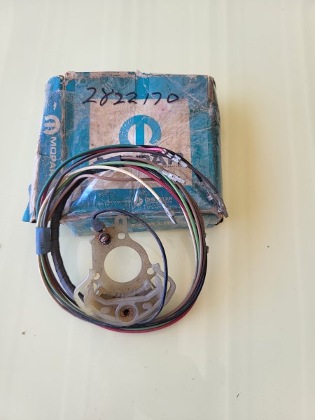

I dont have a 67 switch to compare it to . But this is the correct one for 66 ( not for sale )
I pulled one out I have, and sure enough, 62-66
According to whoever these guys are
Like mentioned the 67 switch ( shown ) is a tad bit larger. So IMO make sure what year column you have.
