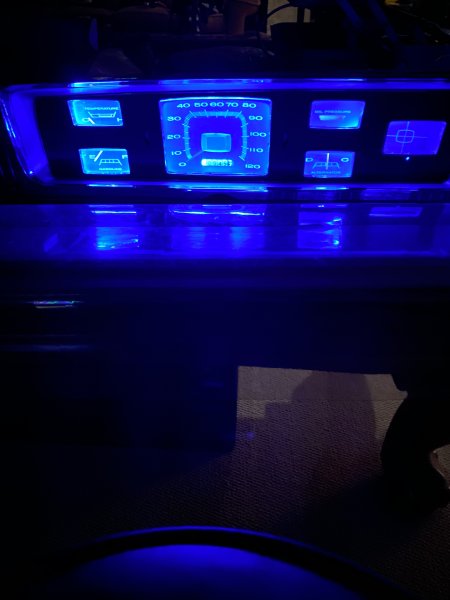

Yup. Amazon generic LED equivalents to original "158" bulbs. Got a 20pk for $13. Yes they will dim, but not manufacturer specified. Many choices on Amazon. I have replaced most of the lighting on the Satellite with LED bulbs over time including front markers, tail lights, interior... left the Wagner headlights, for now.

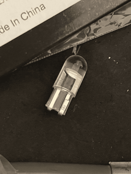

Which ones did you use? There are many different configuration LEDs on Amazon. I’ve read to try to use wire angle ones.
I used these from Amazon. They are dimmable For some reason the turn signal indicators bulbs did not play nice. Even with an LED bulb flasher they would make the signals flash slow. Put the original bulbs in and problem solved. Might be an isolated to me issue though
Marsauto 194 LED Bulb 6000K White... https://www.amazon.com/dp/B079L3WBDN?ref=ppx_pop_mob_ap_share

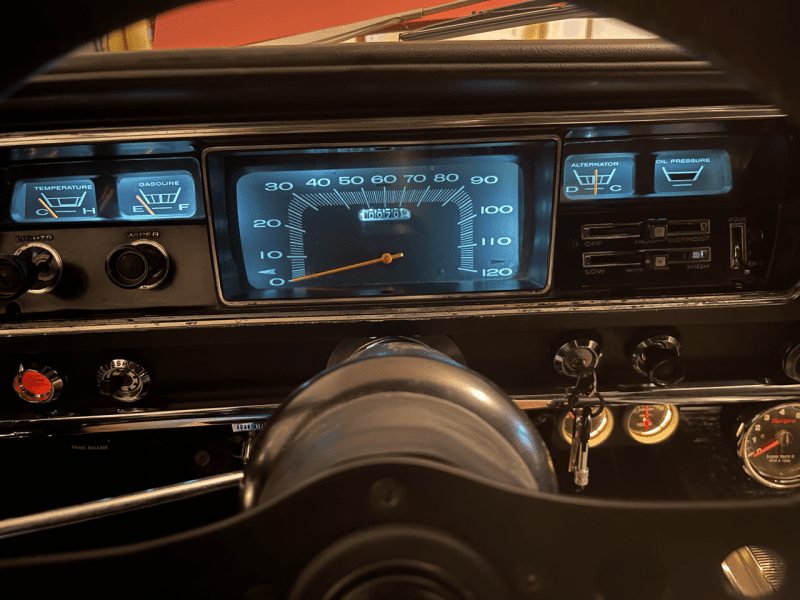

My dash turn signal indicator LED's came out of the same package as they are "158"s also. Installed a "heavy duty" LED flasher unit. Signals work great, flash normally, as do hazards. Most of the replacement LED cover 158, 168, 2825, etc.

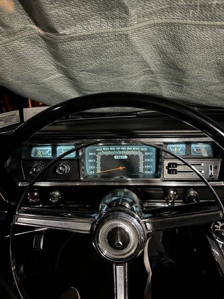

I ended up going with the Superbriteleds. So far they have worked in everything I put them in including the dash turn signal indicators. And they do seem to dim pretty close to normal. Didn’t replace the one in the radio as it would have required a lot more under dash disassembly due to AC but it lights up pretty well anyway.
