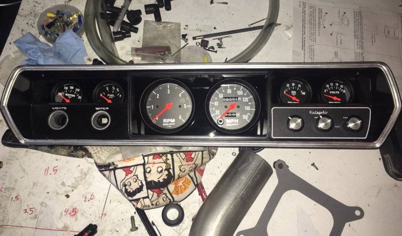

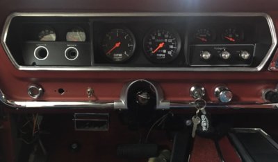

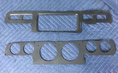

I'm poor so I made my own by cutting out a piece of 1/8 acrylic
Chris,
Can you share who’s gauges you used. That instrument cluster looks fantastic!
Chris, I am trying to copy the gauge cluster you did, it looks great. I did have a couple questions however. Did you use the original back housing and screw holes through that as well or simply mounted the gauges to the plexiglass piece?
Sorry for the slow response have been off the grid dealing with family. So the gauges are mounted to the acrylic and sandwiched between the front and back and the back of the cluster cut out to clearance the new gauges
