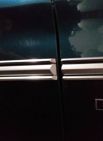

anybody tell me which door side chrome goes where? appears to be a slight cant at forward edge where chrome meets fender,
It looks like you have it correct. If thats the passenger side door on the left.

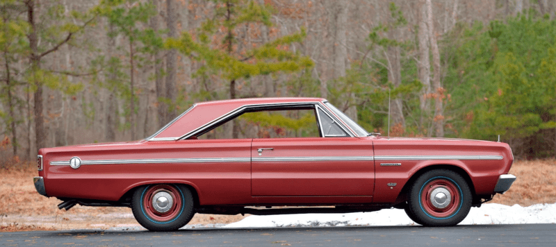

I always try to find a picture of what I need to know. It bevels back towards the door handle.

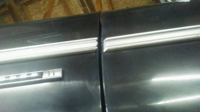

that's correct john! the front fender piece taper towards the door and the door piece at the front tapers back so they don't interfere when opening or closing! the rear of the door and front of quarter ends should be squared off!
