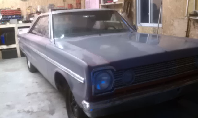

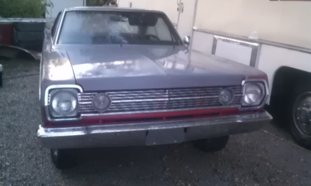

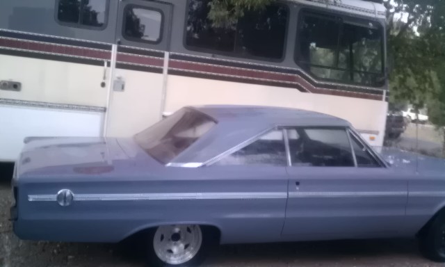

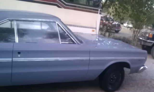

Well i bought this car and will be in need of several parts. I need a master cylinder to start with, but need to know which one to go with. I have seen some info on changing from a single to a double master cylinder. Also will be needing tie rod ends, I noticed that they are pretty worn out. I will be needing motor mount brackets for a 440. I dont know if the ones in my 67 Barracuda will work or not. Any ways I will try and add a couple pf pictures. Let me know what you think. I had to give 1500.00 for it as a roller. I will add pics soon I need to figure out how to load them.

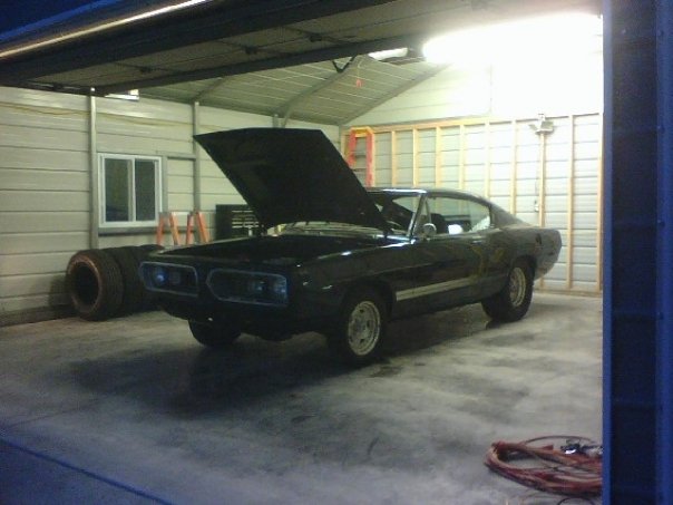

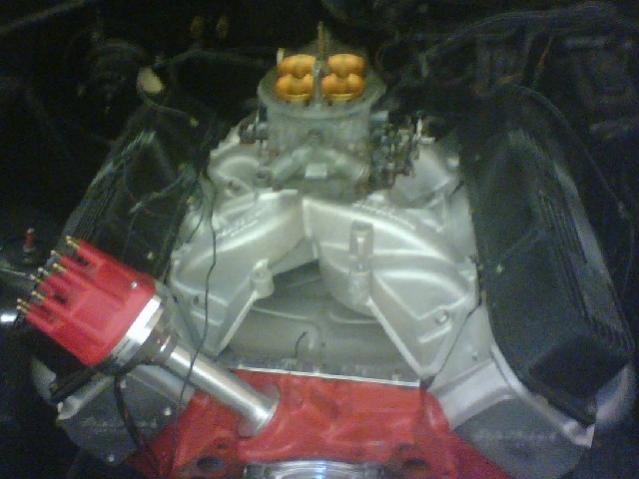

My 67 Barracuda has a 440 in it now and I will be putting that engine in the Belvedere.
