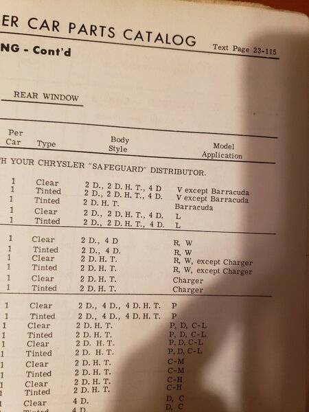

I have a 66 parts book, when I get time I could see if the part numbers are the same if the original poster needs more validation.

I will look it up, but all those little numbers is becoming difficult to decipher these days!

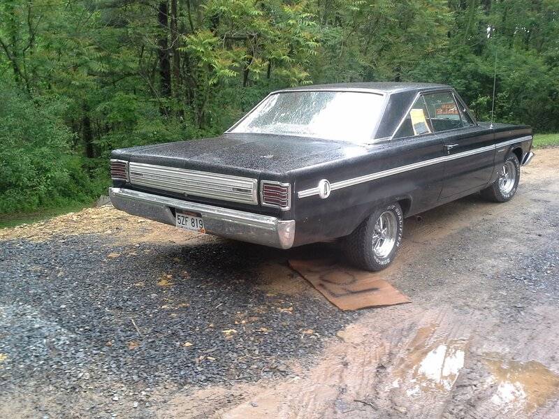

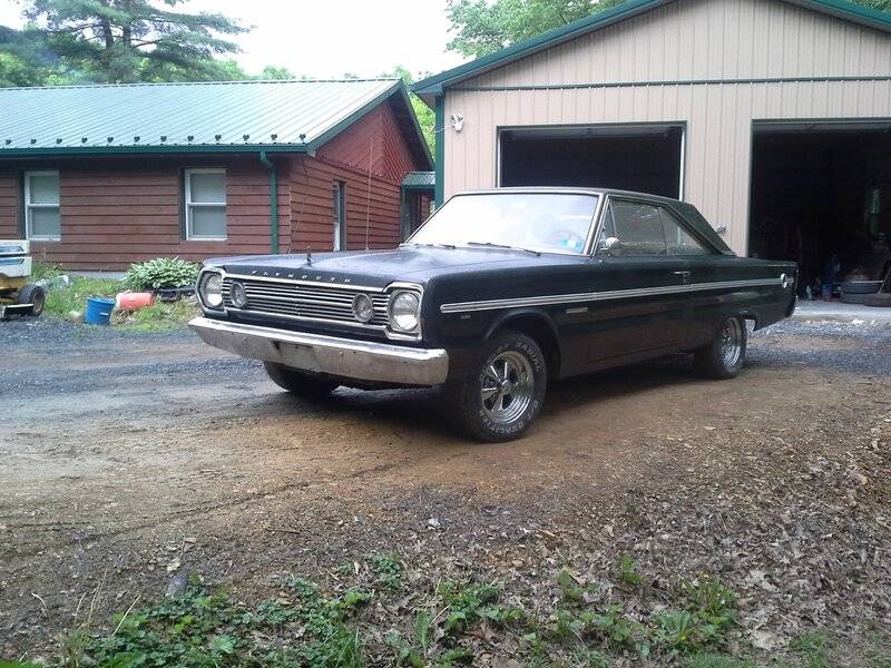

This is one I drive, and have a 66 coronet sedan as well!

here you go! 2529629 rear glass same 2dr,4dr except Hardtop'
