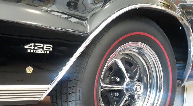

Is there anywhere that has exact measurements on where to put the emblems. Mine's had fenders replaced and no holes for them. I don't want to just eyeball and stab them on there. I'd like to do it correctly. Just got the emblems today. Thanks in advance.
This help ?
I can get measurements if needed
from the bottom of the emblem to the top of the rocker moulding - 4.25"
From the back edge of the fender to the back edge of the emblem - 4.5"
Sorry to be a pain, I don't have that molding. Could you go from the bottom of the body line down to top of emblem and from fenderwell back please?
Could you measure from the wheelwell, from the door edge of fender and from the body line pretty please? Thanks!
from center of the body line to the top of the 2 - is exactly 2"
from the door edge / back of the fender to the back edge of the 4 - is 4+3/16" of an inch
Thank you sir! When I get them mounted next weekend, I'll post pics here. Love this board!
