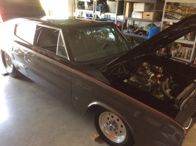

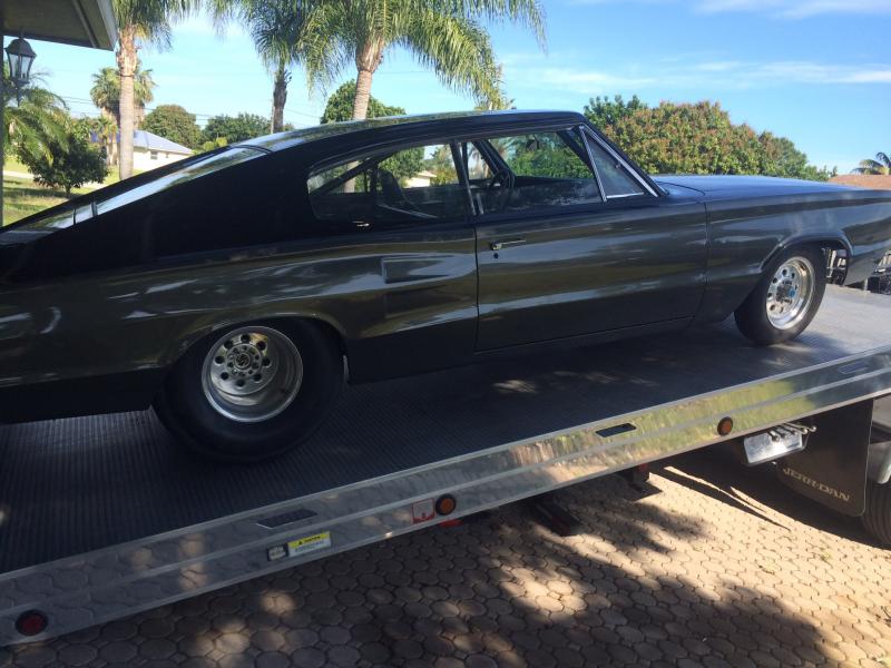

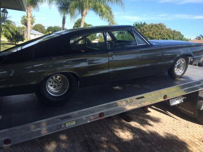

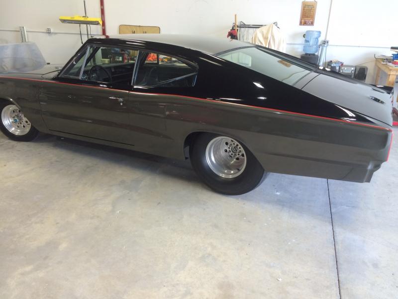

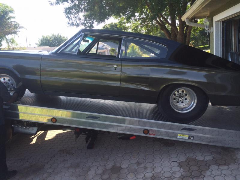

So close....
Bottom picture is after wet sand and buff!

Nice...like the stance! More pics when you get a chance.

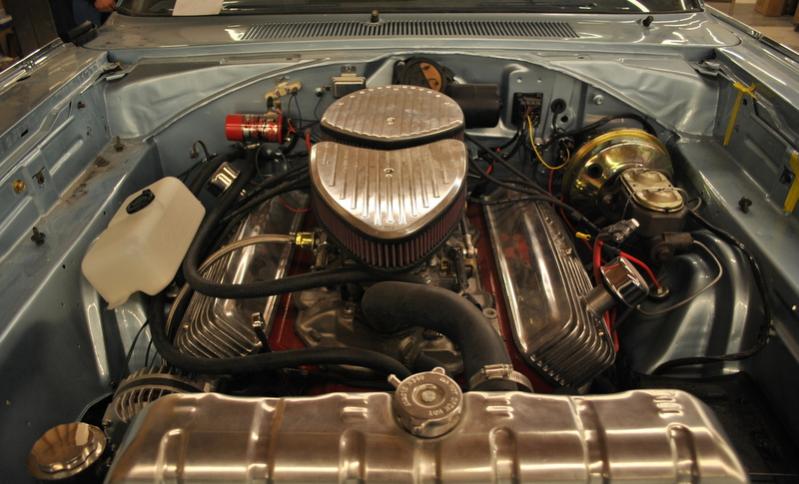

The 66-67's look great with huge rear tires and the roll cage suggests they're all business. What's under the hood? VERY NICE!

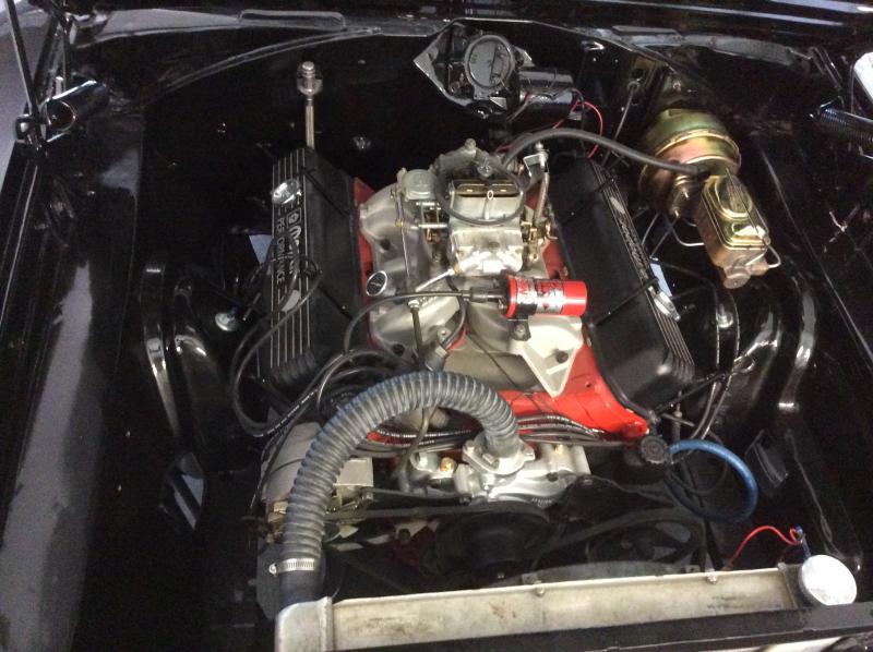

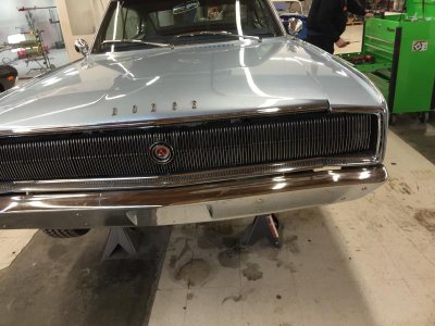

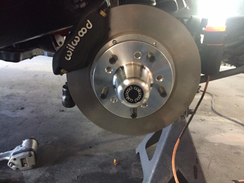

It has taken a year and half to get to this point.
440 .40 over, 727 auto trans, 10 point roll cage, 4:11 set up and 3:55 setup all strange, strange axles 31 spline, narrowed ford 9 inch by s&w race cars, back half 4 link with qa1 coil overs. Tubbed out 33x19.5x15 mickeys....I think I will go down one size tire after burning these off. Four wheel disc brakes by WILWOOD. Just have chrome wiring and fluids left.
