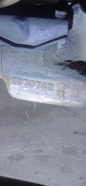

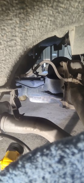

Can anyone tell me what case the 8-3/4" rear end has in my 66 Charger by the pictures I've included? Also what brand of riveted brake shoe is best for a b-body?
I would suggest replacing the rubber brake hose down to the rear axle as well.
It looks to be original.
The 742 is the 1 3/4" pinion differential with shims to set the pinion depth.
